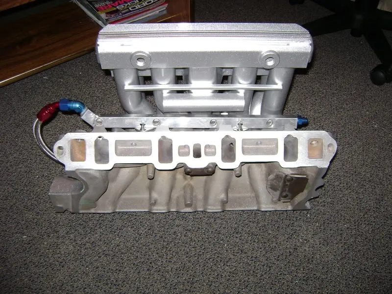

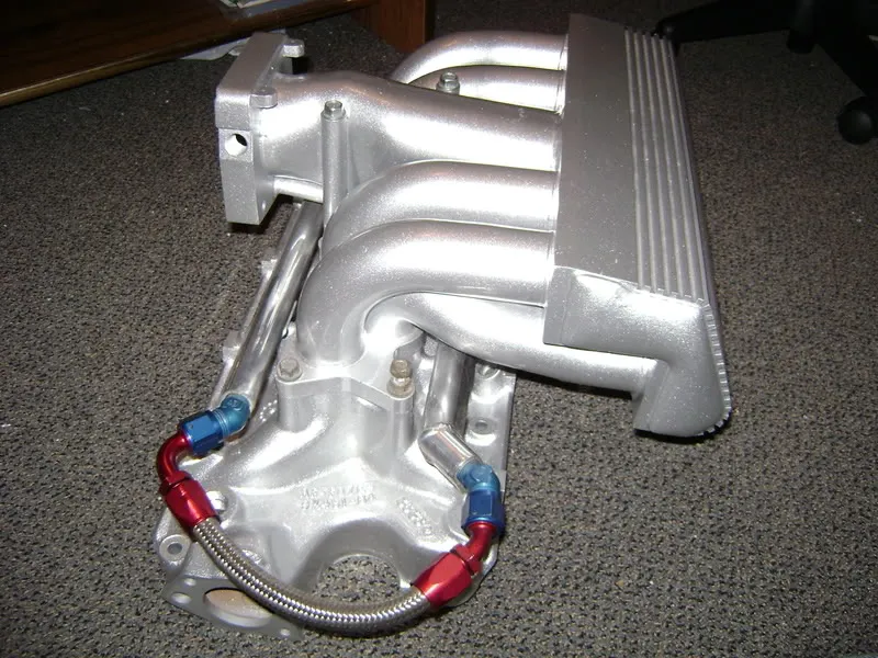

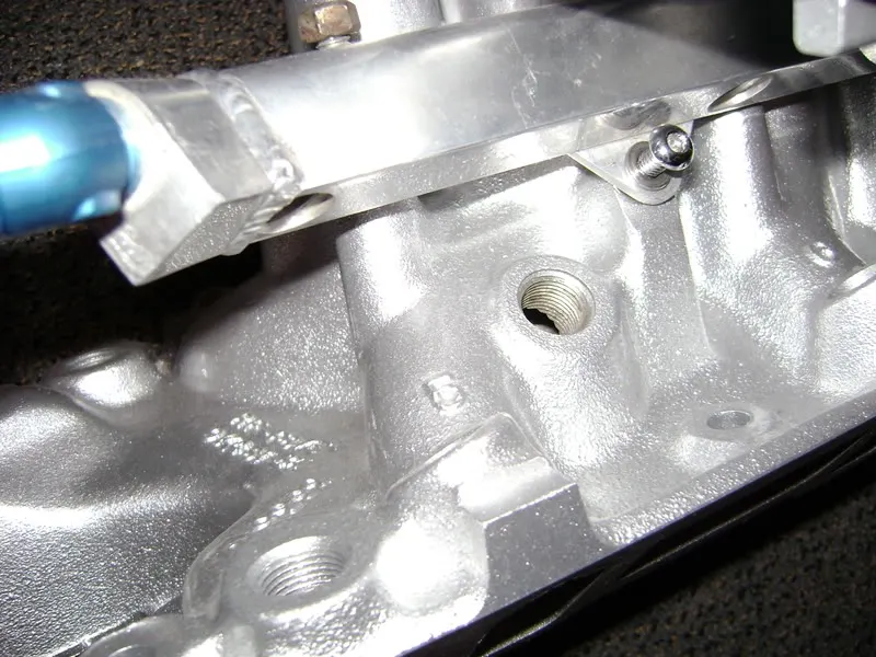

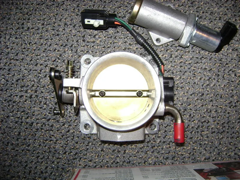

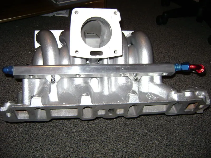

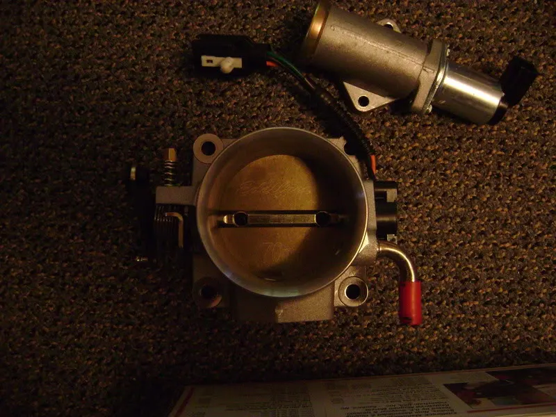

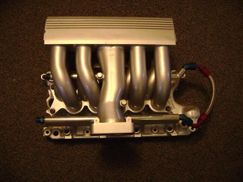

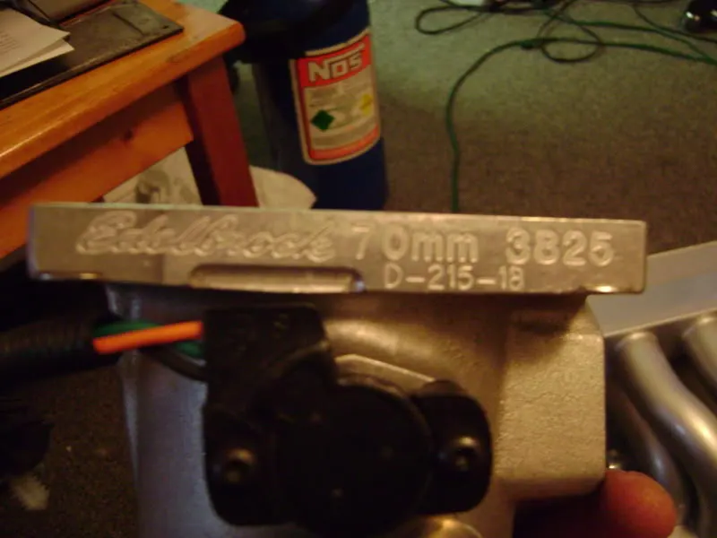

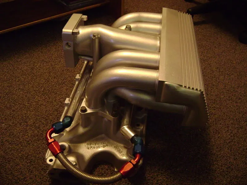

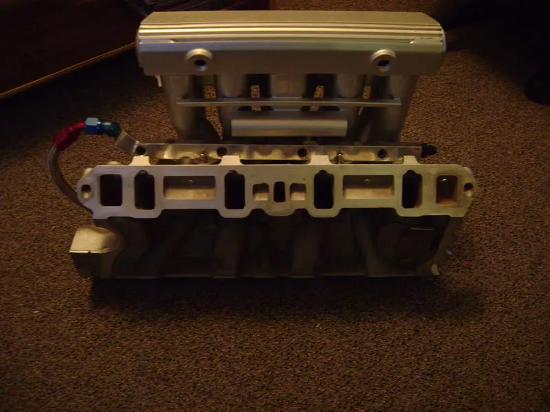

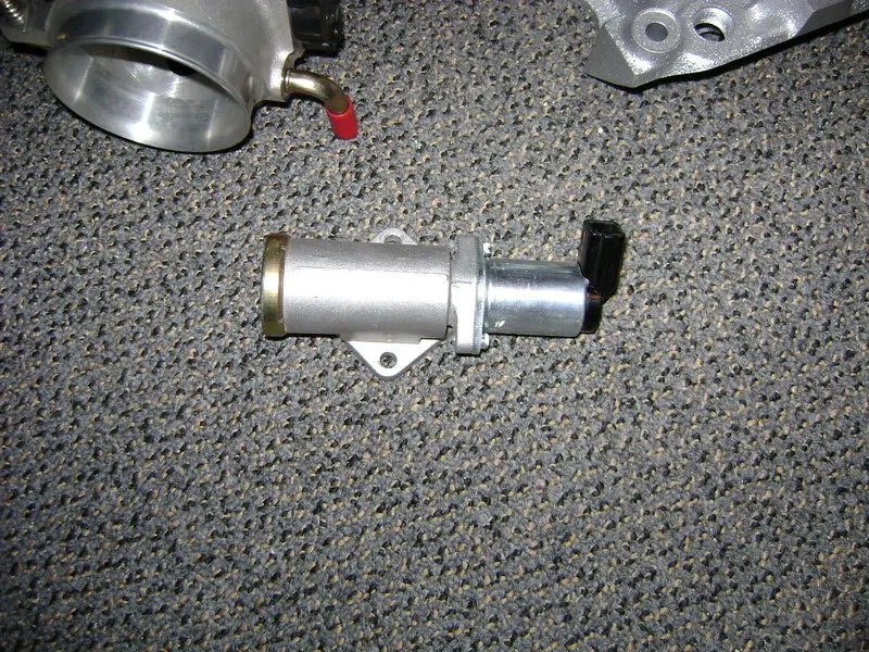

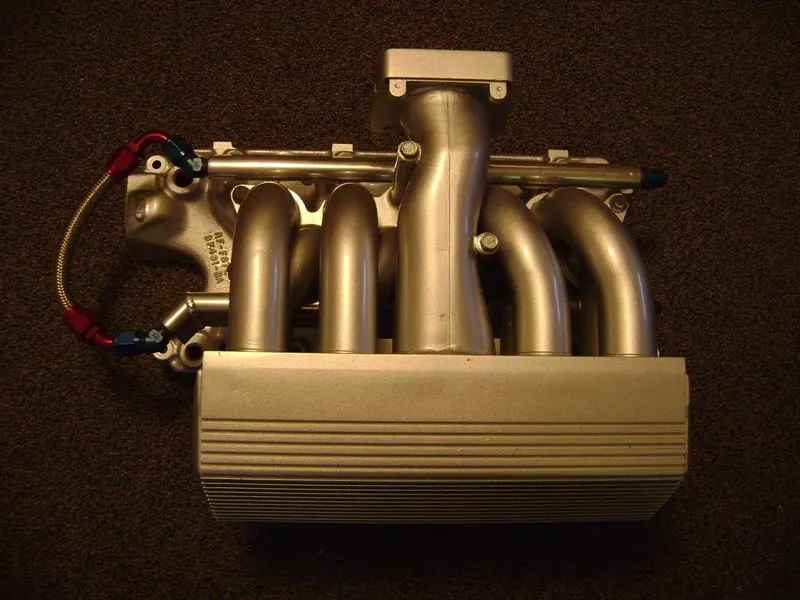

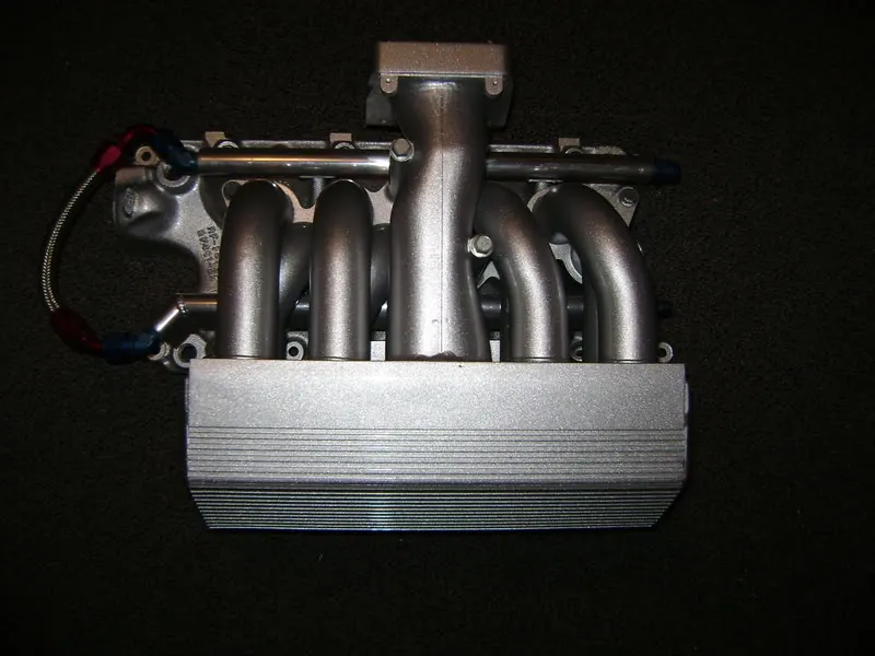

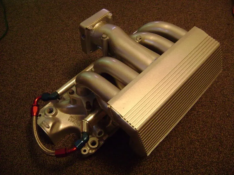

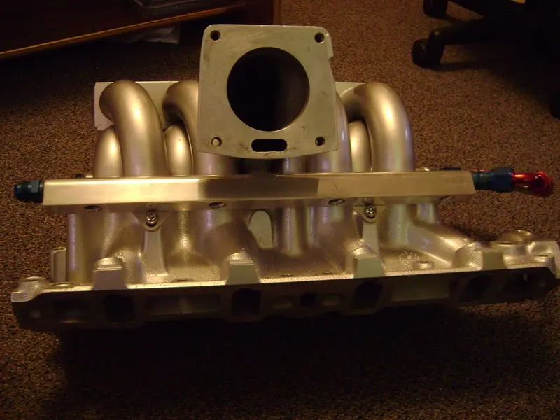

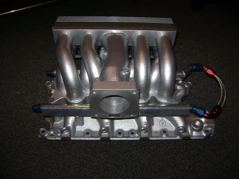

lol this is back. Well still here under my desk and looking cool still. I never really filled everyone in on the condition it was in. Looks like new. so stains inside the lower or nothing. and after a little research the rails are "behind bars" fuel rails
here are a few pics I took a few weeks ago with my new Camera.
