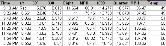

I will offer 2 points of advise that learned about BFD DR.
1. 18 PSI is too low IMO the tires (at least in 275 40 17) like more air. I got my best track results at 23-25psi
2. Get them HOT
If you look at my last major track outing numbers (looking at the 60 foots) the first two are cold at 30 PSI, the third is with a burnout and 30 PSI
All the rest are 23-25PSI and hot. You need to do a very good burnout with alot of white with these tires to get your 60s down. I was at the track a few weeks ago and ran them at 20 PSI and could not get the 60 foot below 2.0x
I also suggest a min of 2 passes on a combo (I do 3 but I also go when it isn't too crowded so I can get alot of passes in) to level out flukes in runs. I also only change one thing at a time. When you had 'the bad burnout' I would have done another run without any changes. As it stands, you don't know if it was the jets or the timing that netted you what in your gains on your last runs.
On edit: also note, I start at idle for those noted 60 foots which is 750 RPM.

Nick, why would you leave at idle? You have a torque monster in that thing. If you left at a higher rpm you should cut your 60s down a lot also. I really don't have time to 3 runs at this track as it is crowded and I really don't want to burn up my clutch from back to back runs lol. I do try my best to run again when something screws up, like when we left the vacum hose off. One of my main concerns is that I'm not getting a good white burn out as the car for some reason is walking to the left. I think might have figured it out though. I know I needed to be doing one thing at a time, in reality I should have started with the traction and getting it to dead hook and lower my 60s before playing with the carb but didn't do that either :nonono:
Even though I have a 3k stall I was overcoming the rear brakes below 2k RPM so it was next to impossible to foot brake it up to something I could 'launch' with. I'm working on the problem. The new Master cynlider is sitting on the work bench and I have a line lock sitting in a box.
