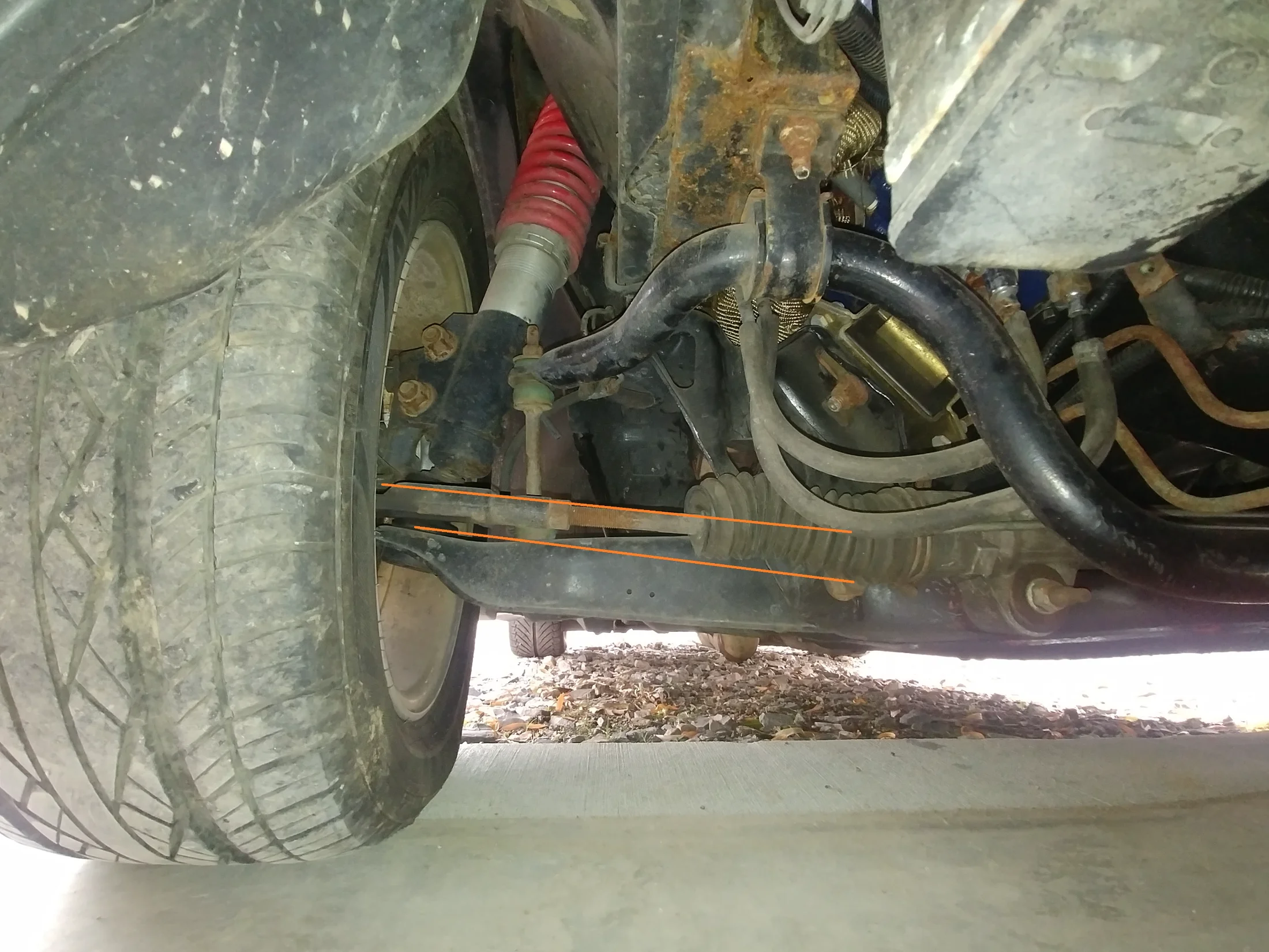

Depends. How is your front alignment right now? If it is correct, then you could put SN95 ball joint in your fox control arm. Take a picture of your current set up from the front with suspension under load. You will want to see the control arm and tie rods. This can help determine if you need a bump steer kit.
You want the line through the pivot point on inner tie rod and outer tie rod to be as close to parallel as possible to the line through the control arm pivot point and pivot point of the ball joint. I'm not perfect here but I am pretty close. I have a 90GT with 96-04 spindles, I relocated the lower control arm mount inward 0.5" and upward 0.5", and I used offset rack bushings to LOWER the rack (most use them to raise the rack). I am using stock tie rods on both ends and NO bump steer kit. My lowered set up pictured above.

That's funny, I have 96-04 spindles with fox control arms that have been relocated 0.5" inward (same control arm mount location as pre-88 cars). My issue was too much camber so I slotted the strut mount slots and have camber plates almost all the way up. Alignment is perfect and haven't touched it in 10 years with no abnormal tire wear.
When I first assembled the car I had a pair of SN95 tubular lower arms but took them off as the tire was pushed out too far.
To get the front aligned anywhere close to spec the top of the tire would not tuck into the fender. The lowers were changed out for stock fox lowers and all is good.
EDIT: Rim shown here is a 16x8 with a near 0 offset IIRC.
