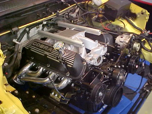

heres some pix of my 2001 focus 3 door im doing a 302/5 speed/ RWD setup.
PM me if you want to discuss the project in detail- i have many pics of buildup
Dan
