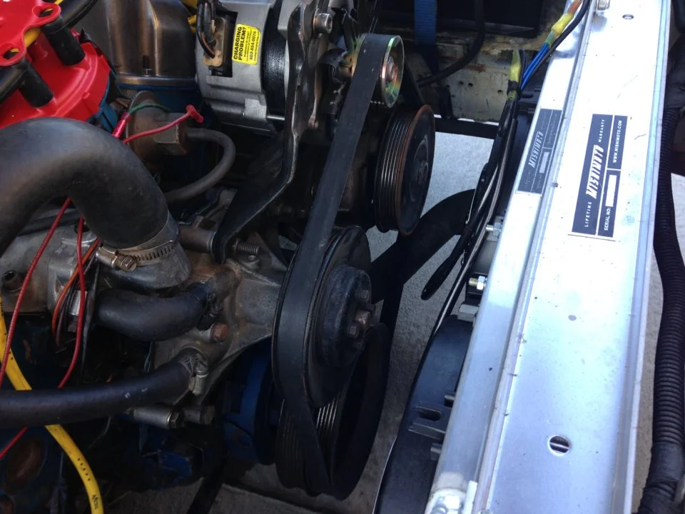

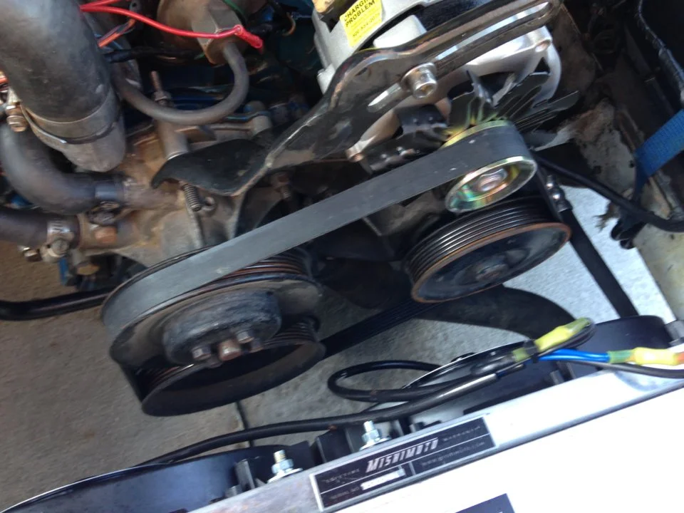

Yeah, it also has the non-mustang standard rotation waterpump belt setup. Crown vic stuff maybe? Anyway, foxes use a reverse rotation water pump, bud. This meaning the way the belt is routed the non ribbed side rides on a smooth wp pulley. You need to confirm you have the correct water pump for that belt setup or you will certainly have cooling problems.

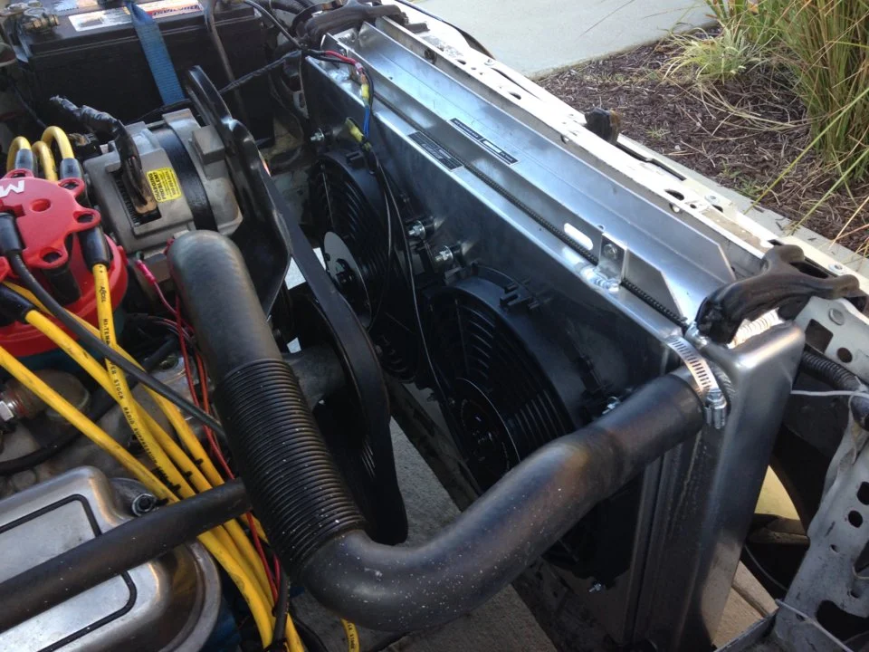

So far no cooling issues. But since I'm not sure of the set up here are some more pictures for you guys.

Ok, just understand if you ever need to replace the waterpump, dont buy one for a mustang or you will have problems. What kind of carb is on it? I'm guessing edelbrock?

What is the diameter of your water pump pulley? It looks a little too big. What boosted is saying about the wp is its usually a smooth pulley, not ribbed.

The WP pulled is ribbed. Maybe PO got it right?
