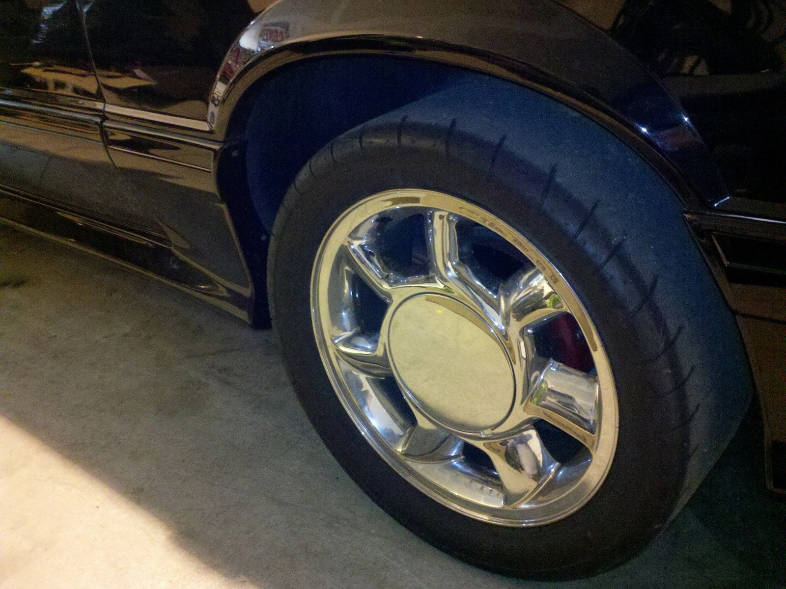

I just put a set on a 93 Cobra, they just rub on hard accell on the inner wheel, a little heat and beat will take car of that. The rims are 17" x 8" so they buldge just a tad.
I can grab you some pics tomorrow when I get in the shop... I have BFGs on it, I feel they last the longest on the street. The Hoosiers and MTs are much softer and dont last long on a driver.
