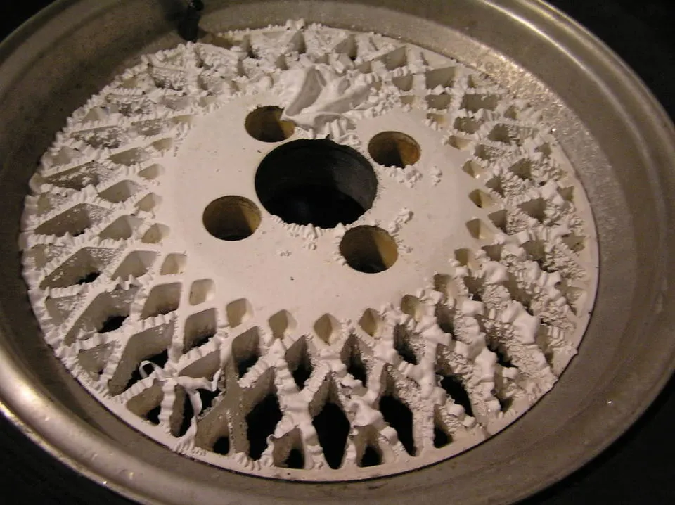

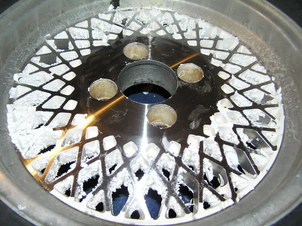

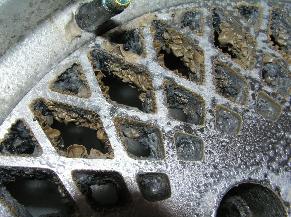

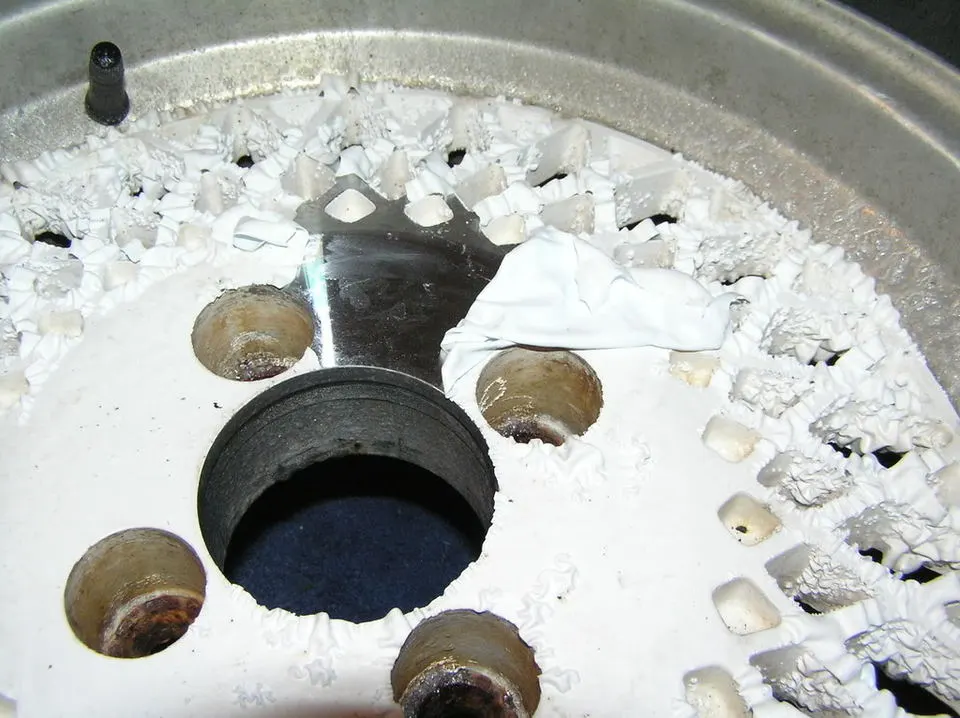

I tried a few different "professional grade" paint strippers at about $10 a pint and they all sucked, or suffice to say the required scraping to get the job done. Then i got a tip about using Permatex gasket remover....and holy crap is this stuff hardcore.
This is after the paint stripper wouldn't touch the insides of the spokes, and after 15 minutes of sitting.
The best part is that it's only like $3.50 a can vs. the $5 a can for the spray paint stripper and it works 100% better.

Unbelievable....that stuff is fantastic. Also i'm super thrilled about the 2 white rims as they seam to be original white rims and that's only one later of crap that needs stripped off.

Man for $4 a can you can't beat this stuff. The time i've saved just being able to spray it on instead of brushing it and worrying about it dripping is enough to justify having to buy more cans of it. This is gonna be what i use to clean metal parts from now on. I can't wait for a warm day so i can hit my turbo housing with it.
