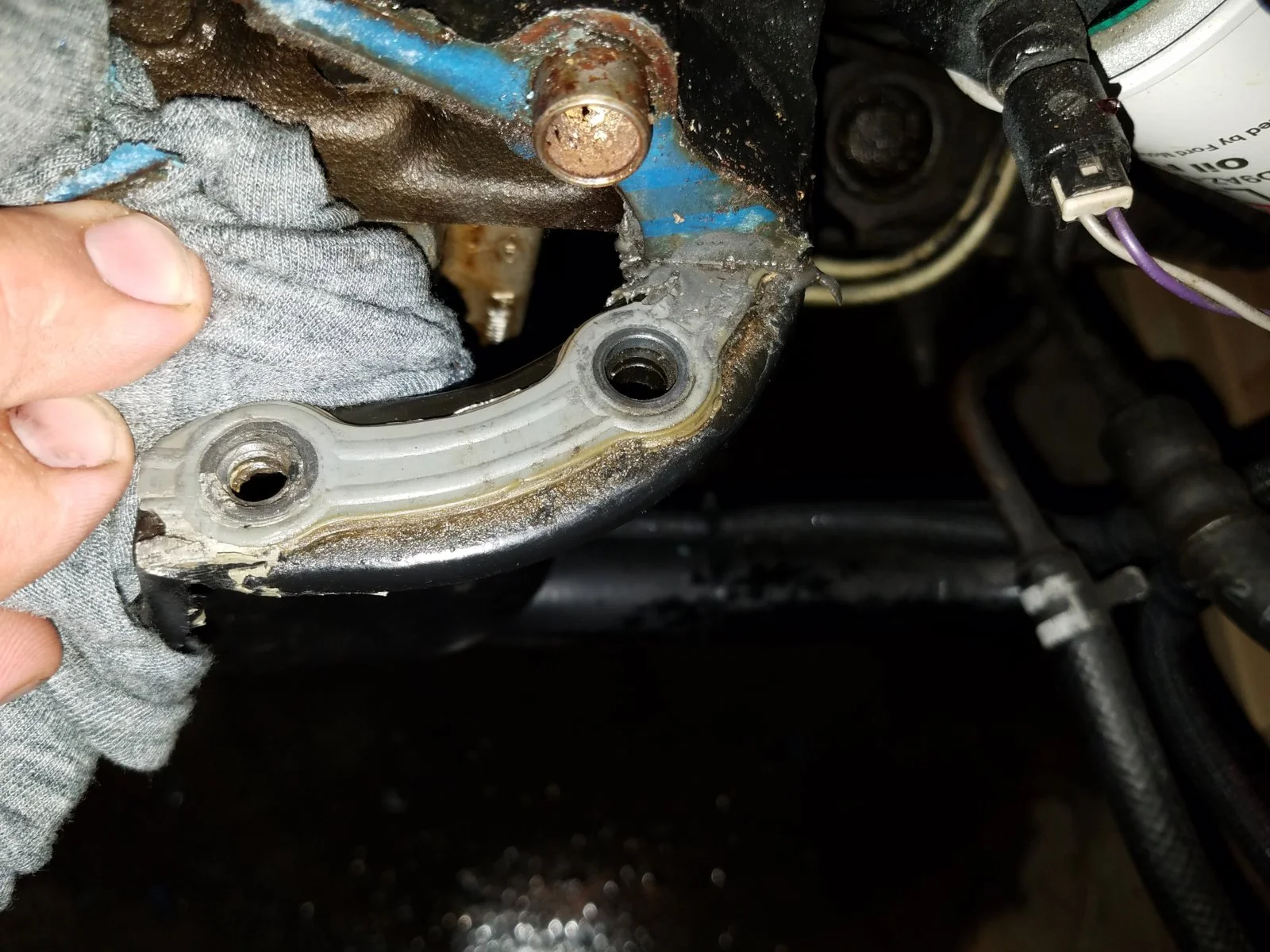

Timing cover was stuck but finally got that off. Couple of questions...the gaskets are a PITA to scrape off lol. I got them pretty decent but want them better and had a thought. Any problem with lightly sanding the timing cover gasket surfaces with my multi tool then just pressure washing really good to get rid of any sand particles? Then i can get it good as new. The oil pan gasket looks to be in good shape but was skimmed with rtv on both sides it seems. Seems to have a metal core. Should i reuse that and juet clean it good re-skim and rtv (the goodstuff) the corners where it meets the block? Or remove that piece of gasket?
Thanks.
Do you want to only have to do this job one time and get it right the first time? If so go back an re-read my post on timing cover removal and replacement. Do not jump around, do not skip any steps.
{b} Do not get abrasive material anywhere near the engine.!!![/B] Sandpaper carries the same type of warning as Scotch Brite pads. Both are abrasive and leave loose grit behind which will do serous damage to the engine internals.
I have been following your directions thus far...I definately get it about the scotchbrite/sandpaper near the engine/block i was only referring to the timing cover itself since it is off the engine and i would pressure wash it after to clean off any debris. I figured since people sandblast parts etc it wouldnt hurt but if thats not a good idea i wont.
You don't want to use a sander on aluminum, there are specific little pads you can put on a drill that is for gasket removal on aluminum, I don't know what they are made of or what they are called, they don't let me near power tools at the shop :shrug: @74stang2togo would know, maybe, I think he should know, ah, unless they don't let him use power tolls either

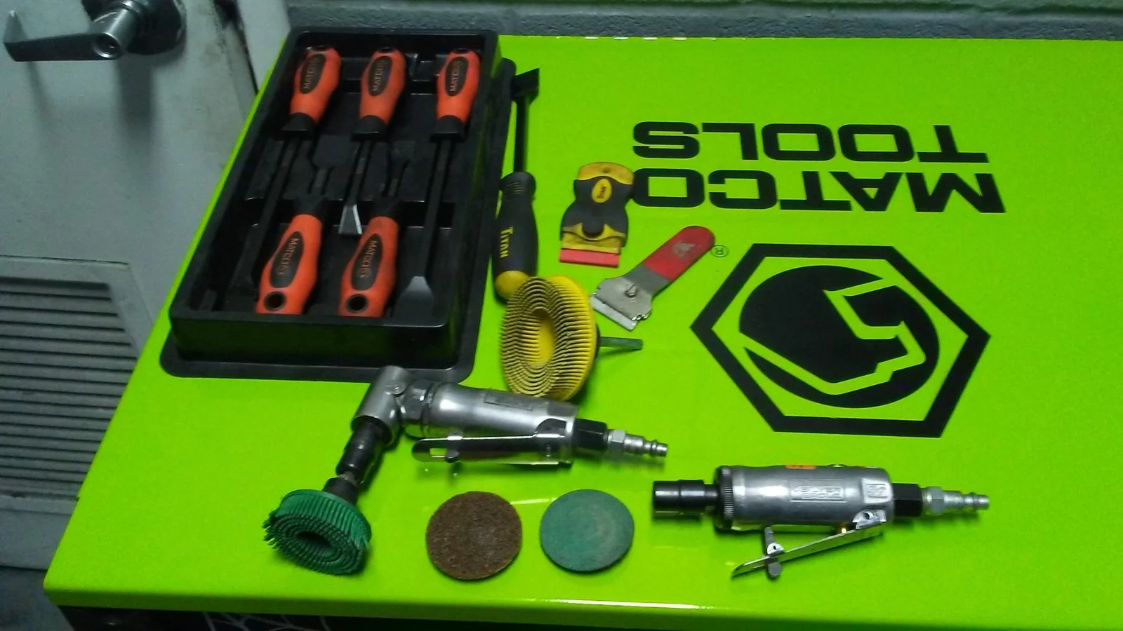

I buy my own tools, so "they" don't get an opinion.
That's what's in my gasket/RTV removing arsenal at work.
Now, a DIY-er obviously shouldn't go buying Matco/SnapOn/Mac/Cornwell, and you really don't need to. Get Harbor Freight's air grinder (I prefer the 90 degree style for most work), then order the Roloc discs of your choice on Amazon. The discs with rubber fingers do the least damage to aluminum (pretty much none if you're careful) and a Roloc disc holder as well.
For a small scraper with a razor blade, your local parts store has them for a couple bucks, that's where both my Titan and CTA blade scrapers are from. I have a plastic razor blade in the Titan for delicate work. The big Titan scraper came from Northern Tool, but I've seen them at Autozone as well.
Now do those roloc discs leave an abrasive material behind? Was looking them up yesterday and it sounded like they leave behind abrasive dust? They look like they work great. I see some ppl love them and some say a razor is the only way but even being super careful and taking my time i think the razor has the potential to do more damage to the aluminum.
They use those roloc things a lot around the shop, I still use the old razer blade and scraper method, as long as you use the right one for aluminum there has never been a problem.
There also is a spray on gasket release product but I've never used it.
The rubber ones with the fingers at worst will leave behind rubber powder and gasket dust if you don't mask or mitigate that from happening. The brown and green discs with the scotch-brite and sandpaper-like material can leave behind an abrasive residue and are best used for parts that are off the engine that you can further clean with brake parts cleaner or a parts washer.
