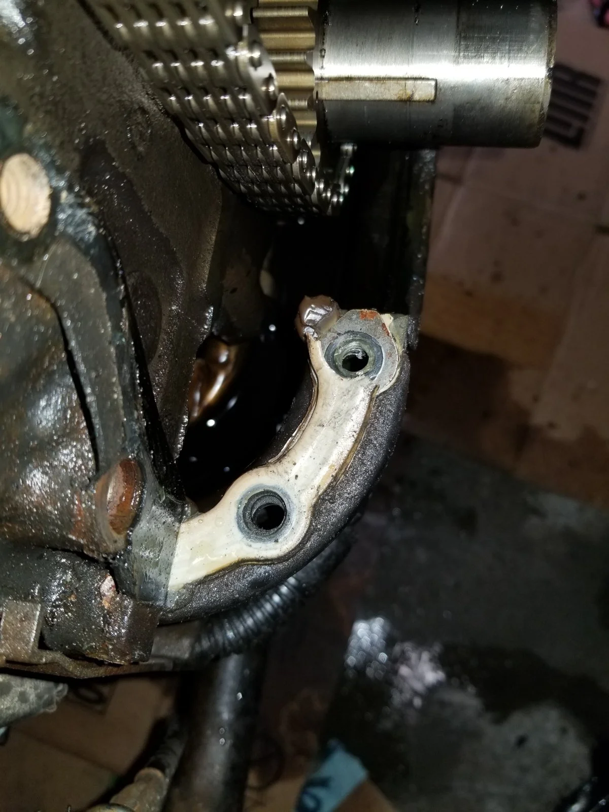

Hi, I'm doing the same job. I've read through this post but I dont seem to see were the removal of the existing metal gasket is addressed. The technical part of the post talks about trimming a full size Felpro gasket instead of using the cork that comes in the timing cover gasket kit. My existing oil pan gasket has a metal core. I'm not sure how to trim it while on the car. I really dont want to have to pull the oil pan at this time if I can avoid it. 20181223_145936.webp
If you have the rubber coated metal core gasket, you should be able to reuse it if it wasn't damaged during the disassembly process.
The metal core is a problem; the only thing that will cut it is a pair of metal cutting shears or a hacksaw blade.

Thanks jrichket for the info. The rubber just fell off the metal so it's just bare metal at this point. The thought of cutting into the pan by accident or worse yet filling the engine with abrasive dust is nightmare fuel! I'm in the process of rebuilding the font suspension so the only thing on the k member at the moment is the rack and the control arms. I picked up an engine support today. I plan on going ahead and removing the k member so I can just pull the pan. I also bought new prothane motor mounts and a prothane trans mount to round out all the other upgraded prothane bushings. Any words of wisdom on dropping the k member?
I got the K member out of the way. Next step is to replace the gasket. So the last time I installed an oil pan gasket the method to use was clean everything up really good. Get a good gasket, use some RTV, and don't over tighten the bolts holding the pan on. No shame about it, shade tree stuff. I'm still a shade tree mechanic, but I'd really like to do this right the first time. This is on a 92 5.0. The gasket that was on it feel apart even though it was a "reusable" gasket, no big deal. I bought a new Fel-Pro one piece gasket, blue with the metal cores. I have the pan off and the gasket ready to go on. This is supposed to be a reusable gasket. Do i need to use RTV on this? It came with a set of the screw in holders to make the install easier.
