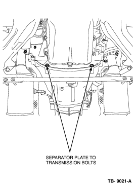

NOTE: INSTALL NEW SEPARATOR PLATE TO TRANSMISSION BOLTS IF MISSING OR DAMAGED. (FIGURE 1)
Figure 1 - Article 08-2-10
PART NUMBER PART NAME
8R3Z-7007-A Separator Plate
W500231-S439 Bolt
