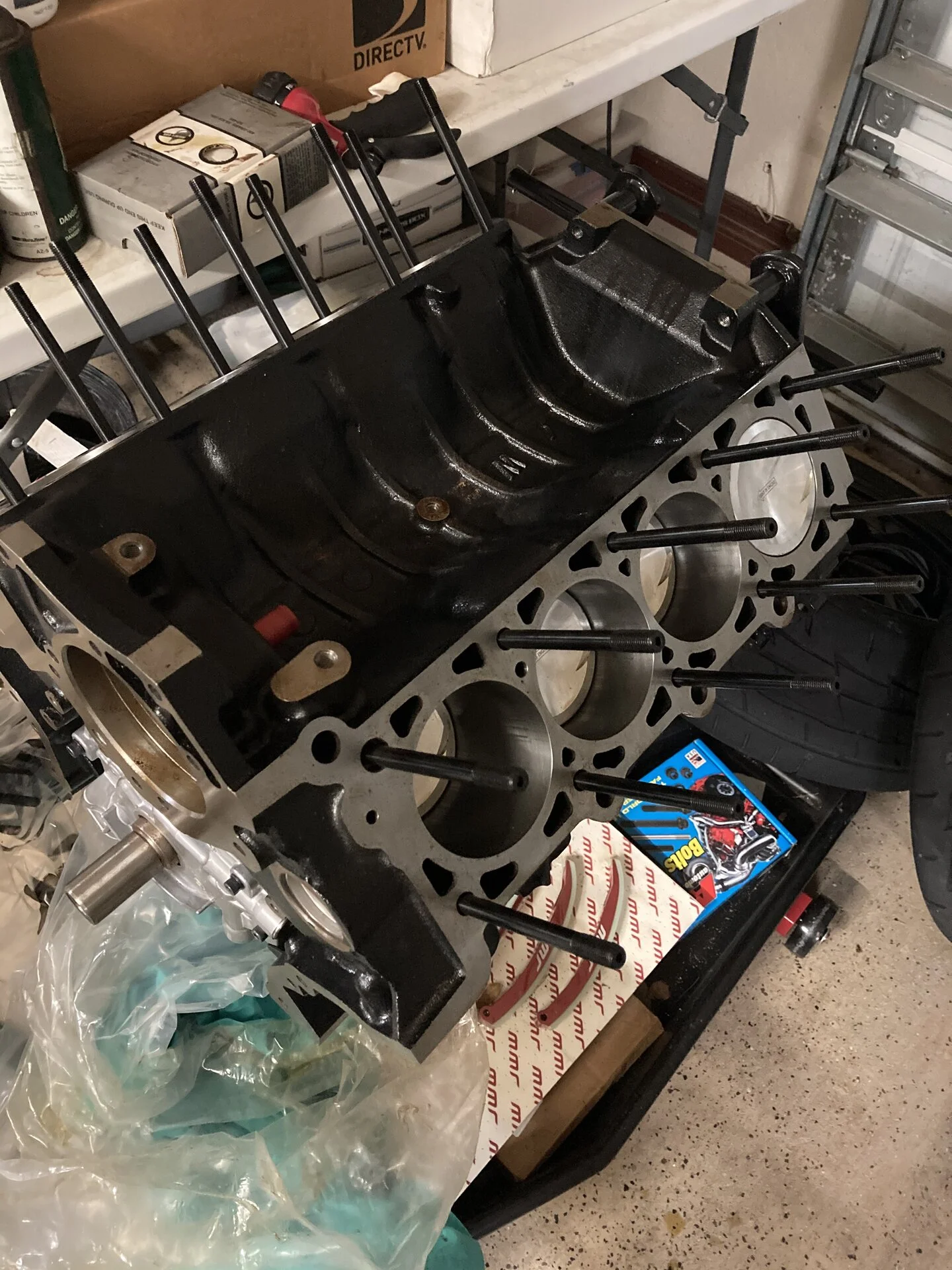

Why can’t I be like this guy?
Just happy with what i
Have??!!
