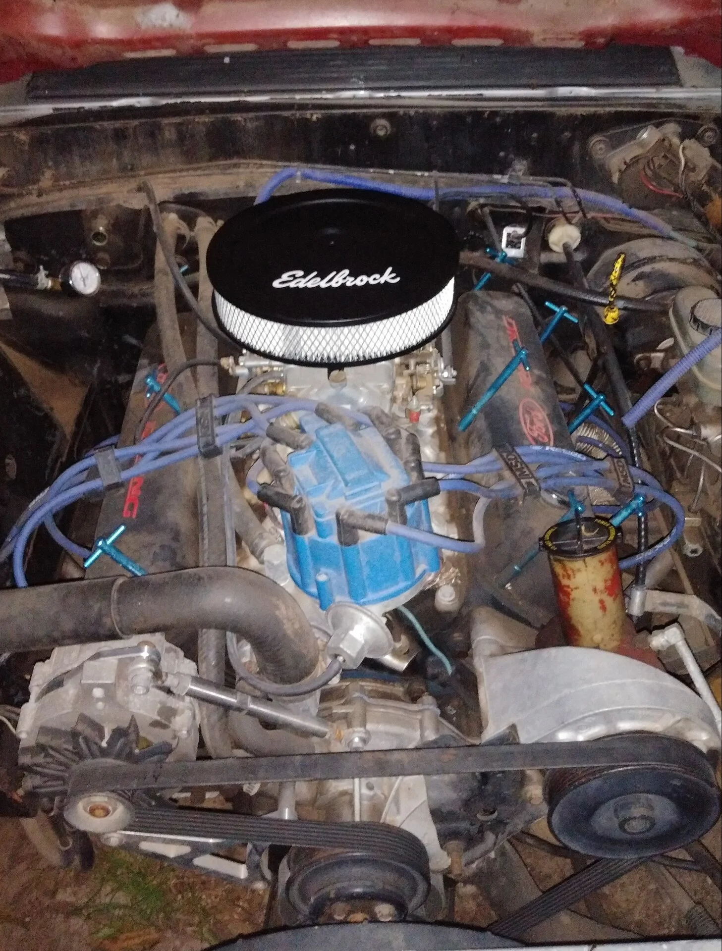

I have a 1989 mustang gt i have had it sitting for approximately 1 year now due to financial difficulties
but on the bright side im almost ready to fire her back this year when weather gets nice i need to know what i should do to make sure everything is okay to fire since it had been sitting awhile now.
Car ran fine besides the starter unbolting itself and heat soaking at starter before i stopped driving it
Thanks again for any input your willing to give!!!
So everything should be okay to fire it up
Just so we all know the engine is not stock it has a 347 stroker is what i was told has heads,cam etc nothing was left stock so just making sure i cross my t's and dot my i's before firing her up and possibly ruining something that could have been prevented

I had someone do some work on the starter and flywheel when i first purchased the car and after that every 8 to 10 times after starting the starter would literally jus be dangling there with only the bottom bolt still snug so i fixed that with a lock nut but the heat soak problem is still got me kinda wondering because will fire right up cold but after being drove needs to sit around 30 mins to a hr to fire back up so ive heat wrapped the long tubes and put a heat shield around the starter so i will find out if that fixes that issue
I've seen similar issues with timing and engine ground issues. If its just clicking it could be the starter or starter solenoid. If it's a slow crank it could be timing or a bad ground connection. You could run one of those ground cables ( parts store pre-made with bolt hole at each end ) from the starter bolt to the k member or the body of the car ( I used a sway bar mount bolt ). Can never have too many grounds.
I've seen the timing off just enough for the car to start cold but would not start once the engine warmed up. Make sure you have the right distributor. It should either be an HEI style with square box on top with coil inside it...or a regular type with a vacuum hose running to a round thing on the side. The one with the module ( rectangle thing...gray or black ) on the side is for EFI only not carburetors.
This is what it is im new to this whole thing so please forgive me for so many questions amd i think you may definitely be right about the ground wire thing because when i was looking the other day it literally looked like the ground wire was about to break it was so old
