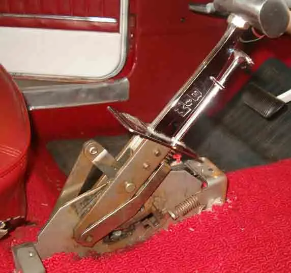

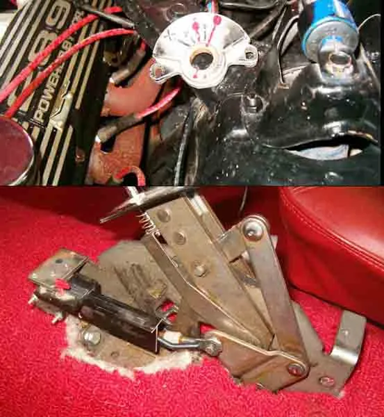

Still having no luck.
A previous post said I could somehow hook the neutral safety switch to the shifter itself. I have attached thumbnails of what I have to work with, and I don't see a way that it will work.
Any creative ideas?
