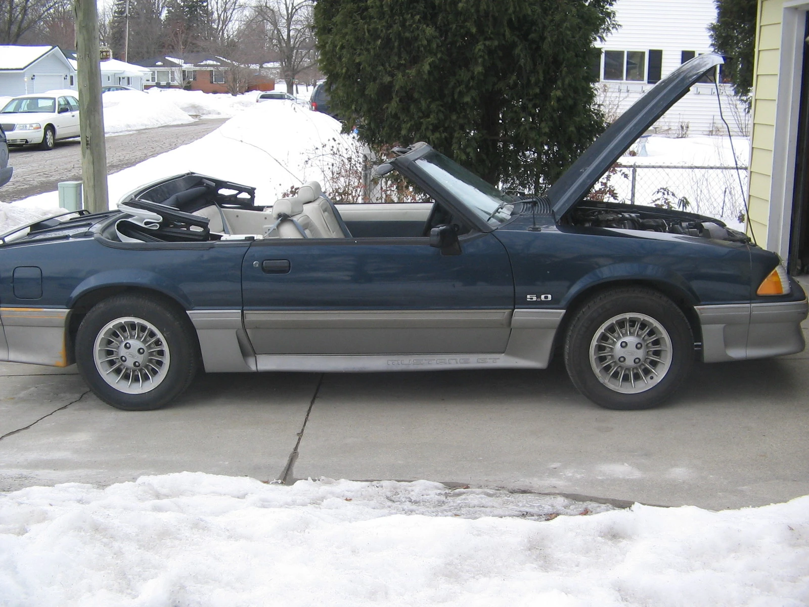

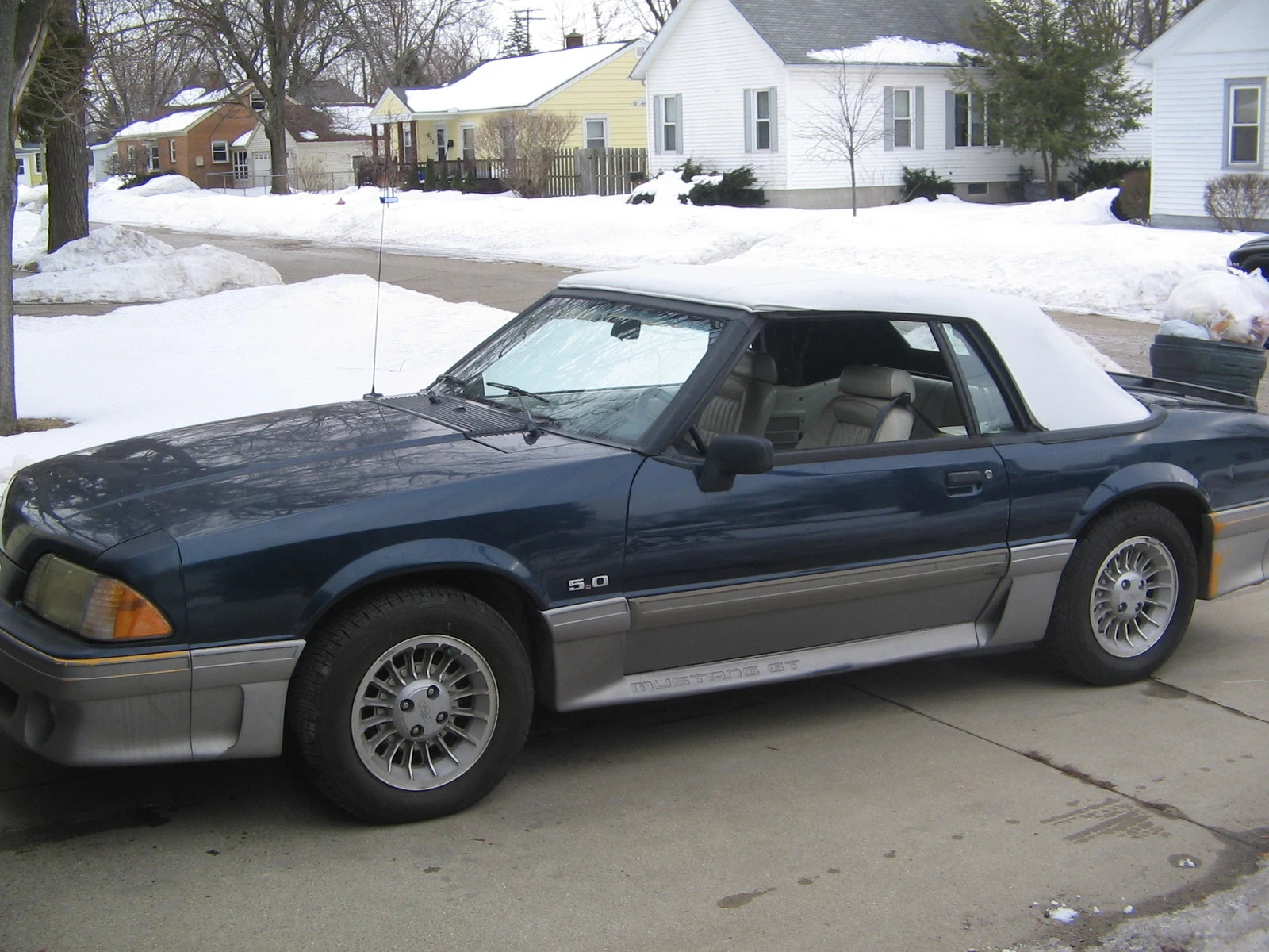

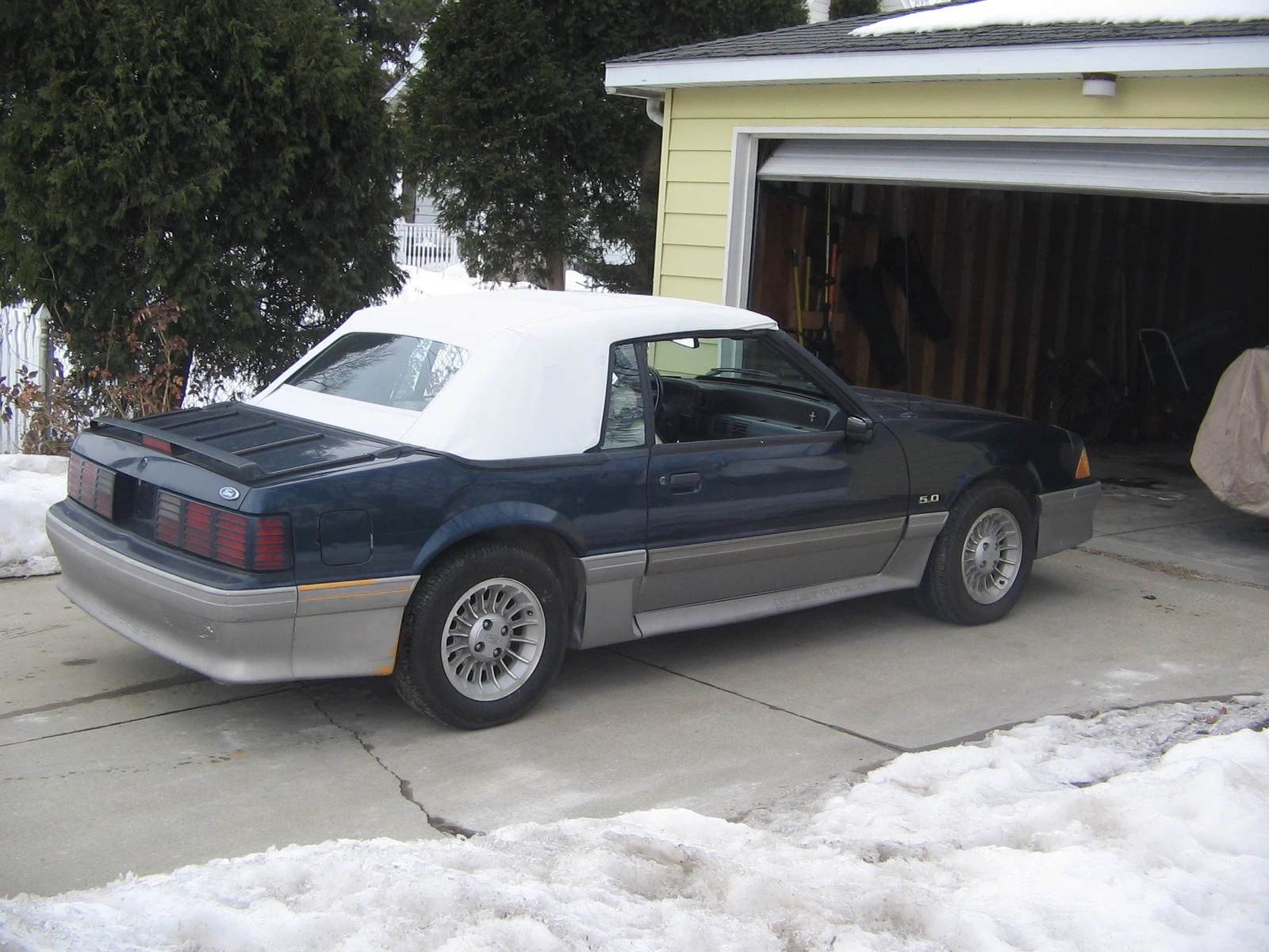

glad to see shes running good looks like a nice car. i am also reduced to driving my 2.3 even in the cold (winter) but i wash it so often like twice a week lol besides i just picked up a rust free 90 GT convertible 5.0 5 speed so its ok for the time being
I like that color combo . Two tone looks much better on a vert but only with ground effects not on an LX . Same thing with the Turbines , better on a convertible GT . I like it ! Hey , at least she doesn't think your ugly . Or ask her for five grand so she'll like the new color scheme .

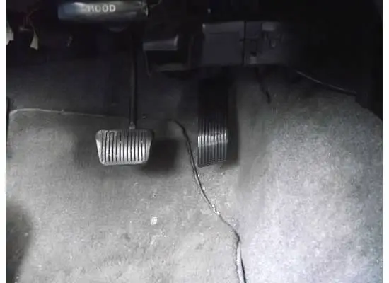

Good weather finally . I put in the power lock actuators and now have my power locks working . Hoo raahh . I even had time to change the tiny a/t gas pedal for the wider 5spd one with a new spring as well as better speakers that I've had kicking around for awhile .
The new speakers sound way better . I only changed the dash and doors but it sounds loads better .
I don't know if it's just wishful thinking but it feels better driving with the wider pedal .
