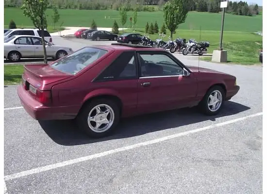

I swapped the 10 Holes for the Pony's I picked up in the Fall .
This was at a Brewery Tour parking lot . We didn't like the beer but it was a fun tour anyway .

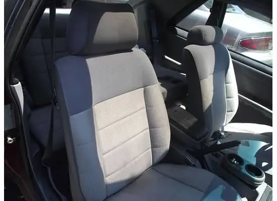

Never made it to Allentown tealtiger 93. I stopped at Greble U-Pull-It first and then went on to Hazleton Pa afterwards . I found a beautiful set of seats in an Escort GT with the headrests . I so wanted them but we were in the Mustang with luggage and a cooler and so on . I pulled the headrests for my seats or I'll sell them if I decide not to use them . the seats were perfect . Grey with the red piping like the SVO seats . After we left I regretted not getting them of course . Should have at least tried to separate the top from the bottom to get them in the back .

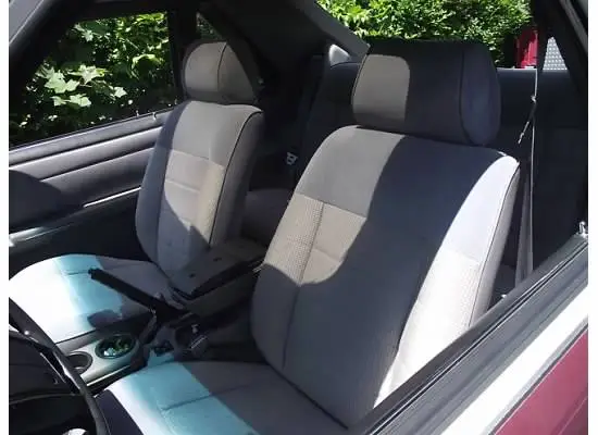

Got tired of driving around with big headrests in the trunk . They look pretty good even if I do say so myself .
The material is an exact match to the LX seats . They were from an Escort GT at the U Pull . Think I paid $10 for both .
I added a little bit of padding while I had them apart .
