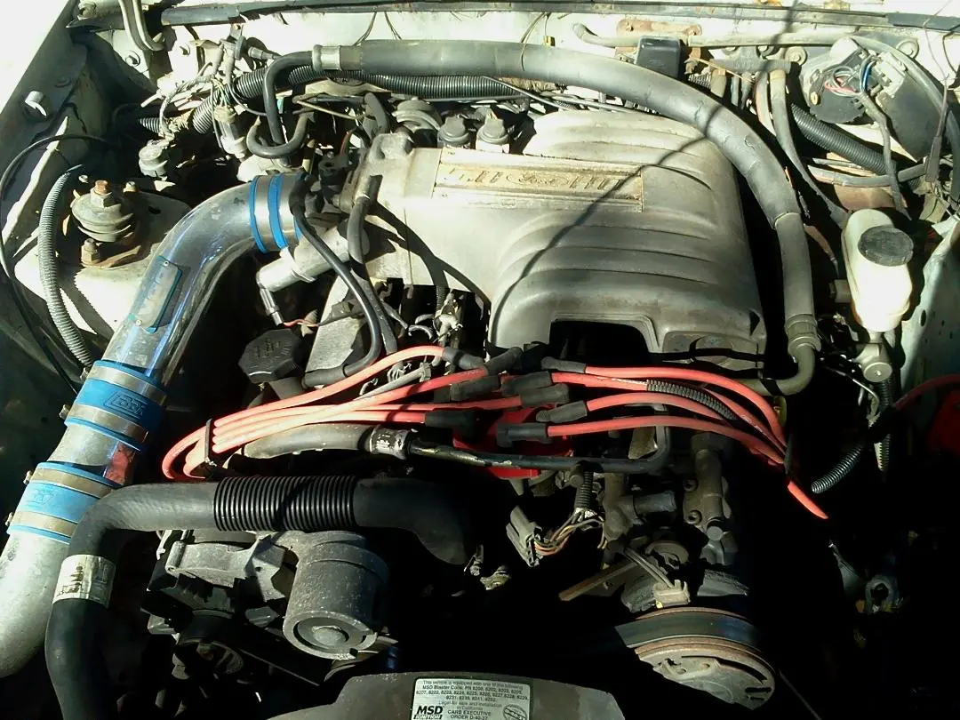

Guy before me put full headers and some off brand that said they were just like flowmasters but sound kinda ricey when you really get on them on the car, and a cold air kit but other than that the car seems bone stock. I do think that the Cold air is running havoc with the Speed density set up from what I have read here and talked to people about. Car doesn't want to run at idle unless you give it some gas and surges slightly still even after it calms down. Wondering if it would be worth the effort to switch it to Mass Air, take of the Intake, or just deal with it...

welcome aboard. Pick up a cheal equus 3145 code reader from Amazon and pull your codes even if the check engine light is not on. This will give you some direction for your plan of attack. I would also do a full tune-up. Post up your questions over in the fox secion.

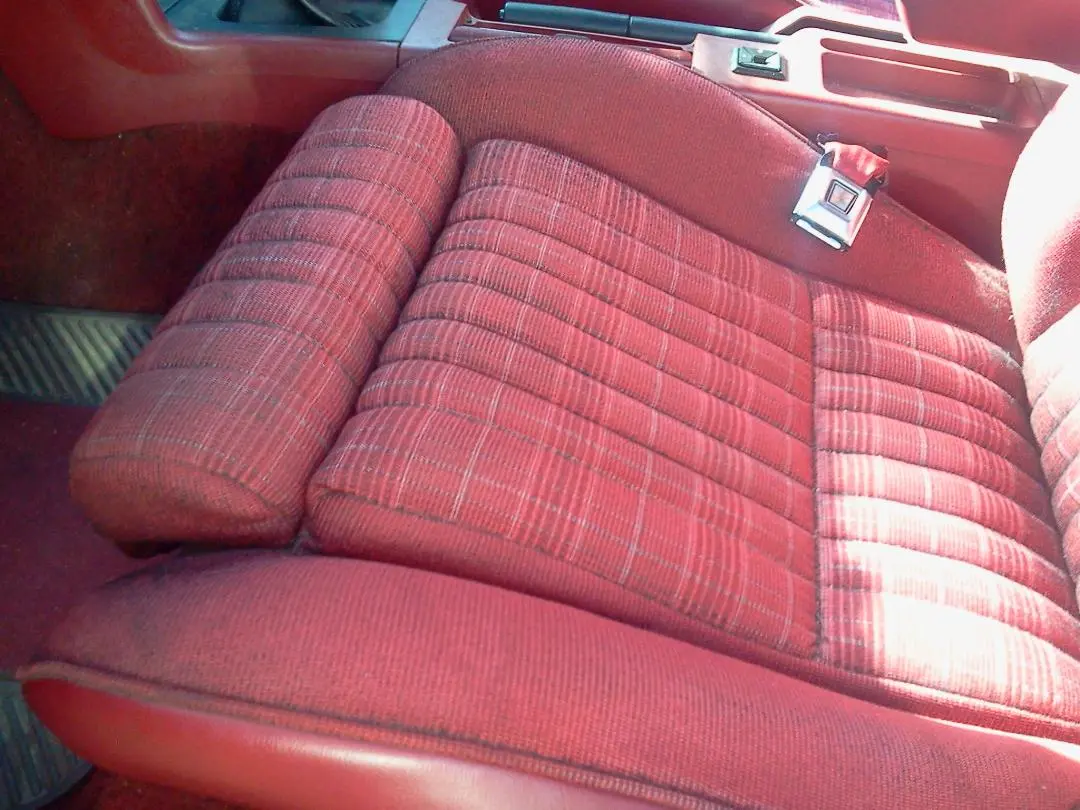

Thanks flstang if I manage to break one of these you will be my first call! I always liked the black interior but after being in it for a bit the red is growing on me! I will have to repair the driver seat its got that mustang gangsta lean going on a little...

The mods shouldnt affect how it runs. Just go through the car and make sure everything is fresh. Plugs, cap, rotor, wires, PCV valve, etc. Run the codes and start addressing any issues that it shows.
Pretty much every fox Mustang has some sort of code stored in the memory.
