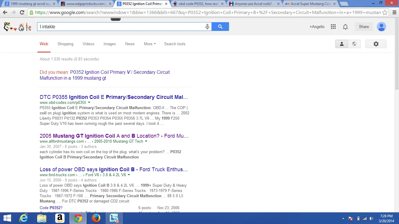

Hello fellas,
I bought a kit of the 8 coils ACCEL new with NGK Iridium plug, and I install them today, after the installation and i have everything hook up, I start my GT and everything was normal, then after 5 minutes the car idle start to die, then it gave me the CEL with the code P0352 Ignition Coil B Primary/Secondary Circuit Malfunction. Then i start to check every coil to see if was loose any conectors, i found that there were some. I try to plug them carefully since they were loose, then try to start the stang and still the same problem with out the CEL. but the stand dont idle at all. Anyone have any good recomendations of what could be?
