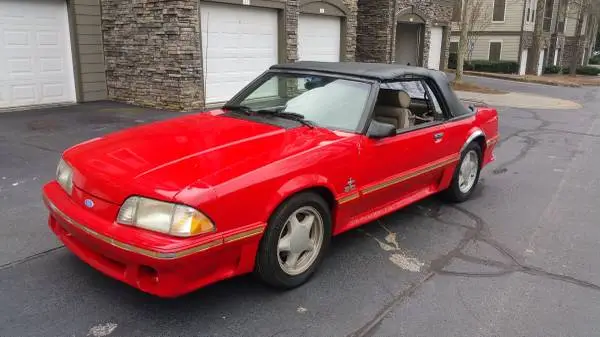

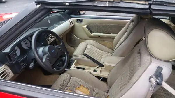

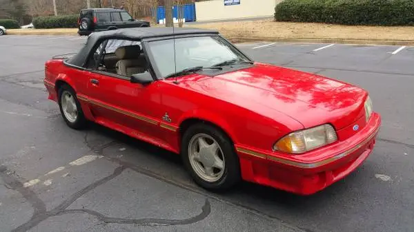

So I was perusing through Craigslist last night looking for a suitable engine/transmission combo for the wife's new-to-her 67 last night. I ran across this ad and thought it might be a good donor car: http://atlanta.craigslist.org/nat/cto/5420451210.html (It may be a dead link as it is no longer available...). Long story short, it is an 87 GT convertible with a 5 speed. It's the combo she wanted to go with in her old convertible that we sold when we moved and what she wanted to install in the 67. Well, I think nostalgia got ahold of her and she wanted her convertible back, so we went and looked at it. It's not bad, a little rust in the toe board area, the engine runs like a champ and has 76000 miles on the odometer. We took it for a short test drive in their apartment parking lot, found it needs a motor mount and exhaust work and talked them down to $2k. So now she has 2 mustangs separated by 20 years. Oh the monster I've created! So now we have 3......
(pics from the CL ad...)
Still using it for a donor or gonna fix it up? Aside from the missing tape stripe and torn seats it looks pretty clean.
She wants to fix it up. Kinda sounds like the syncs are going bad too, so a T5 rebuild is in the cards as well. Been looking but can't seem to find the info I looked up a couple years ago concerning the mass air ecus. There was one that I considered to be the best performing stock ecu that I ended up going with when we put her 84 together. I know the A9L is the most popular, but I cannot for the life of me remember if that is the one we went with or if it was something else. Regardless, there are a few things to do with it before we get into the mass air conversion, but we are going to want to do it. We bought a set of GT40 Explorer heads for the 84 that we still have laying around that we will more than likely throw on this one and probably pick up an Explorer GT40 intake from the Pull-A-Part when we get around to it. I definitely have enough to keep me busy and out of trouble for a while!!

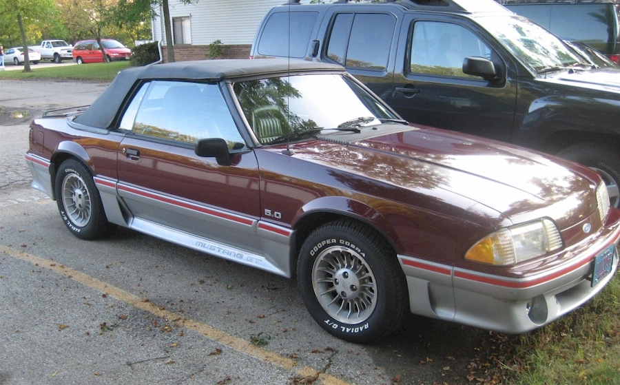

Researched the door tag the other day, turns out that this is how it left the factory:
That was my least favorite combination!

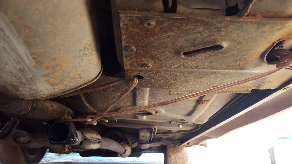

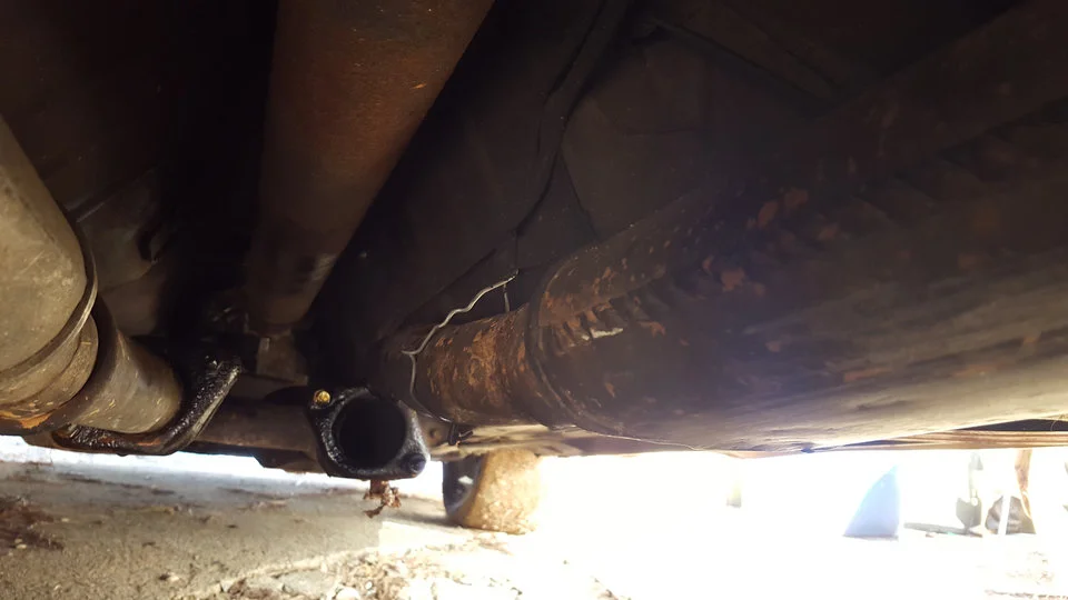

We got the motor mount changed and exhaust done today. Found a little rust in the driver rear wheel well under the chrome trim that was on the car that we'll have to take care of when the time comes. But this is what we found when we were able to crawl underneath it.
Loved the speaker wire!! :D

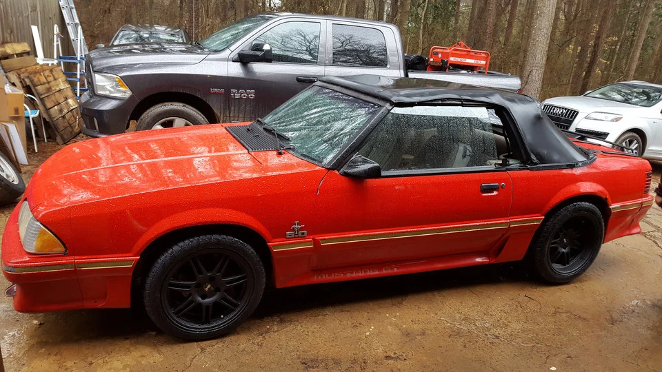

OK, it didn't have any bad joints in the front, but it seems that the struts have seen better days. I have a set of struts and shocks sitting here waiting for installation now. She also got new wheels and tires. We ended up putting them on today along with new quad shocks. The new wheels rub on the quad shock boot, so we will have to look closer next time we get to working on it. It started raining on us while swapping the new wheels in place of the Ponys, so we didn't get to look close enough to see if it was only the boot or if it was rubbing anywhere else. She likes the looks of the black wheels, but I'm not too sure about them. They look alright I guess, but I think the anthracite wheels would have looked better. What do you all think?
On my 95 the factory quad shocks didn't have boots, nor do the replacements. You might just be able to cut the boots off of there, problem solved. You can also flip them if you have clearance issues, that may help if the boot is thicker than the shock body. For even more clearance people often remove the quads (for which new adjustable rear control arms are a good idea to eliminate the wheel hop).
I chose anthracite myself because it stands out more, black kind of looks like an un-dressed steel wheel at a great distance. But in your case I like black as it matches the top, and there's very little silver / chrome trim on the car. For that style of wheel I think I like the black better (I like the anthracite on Bullits).
We flipped the quads when we installed the new ones. Clearance looked tight from what I could see with it in the air and I suspected there might be an issue there, but left the boot on anyway to find out, and found out we did! I'm pretty sure it is only rubbing on the boot, but we'll find out next time we get to working on it.
And I agree with the black looking like an unfinished wheel, but I also think they match the car fairly well. I don't know-maybe they'll grow on me. I think the anthracite wheels would've stood out a little more I guess. But it's her toy, she gets the final say. If she likes them, that's all that matters! On another note, I double-checked the back spacing on these as I was curious if they'd fit the II. They won't, so I can't really just swap them onto mine and see if I'd like them on my car.... :(
Well, I found out the tight clearance I thought I saw was actually -0- clearance. So, we tried the original-ish quads and had the same problem. No more quad shocks! We took them out completely-problem solved! Now on to other projects!! :)
