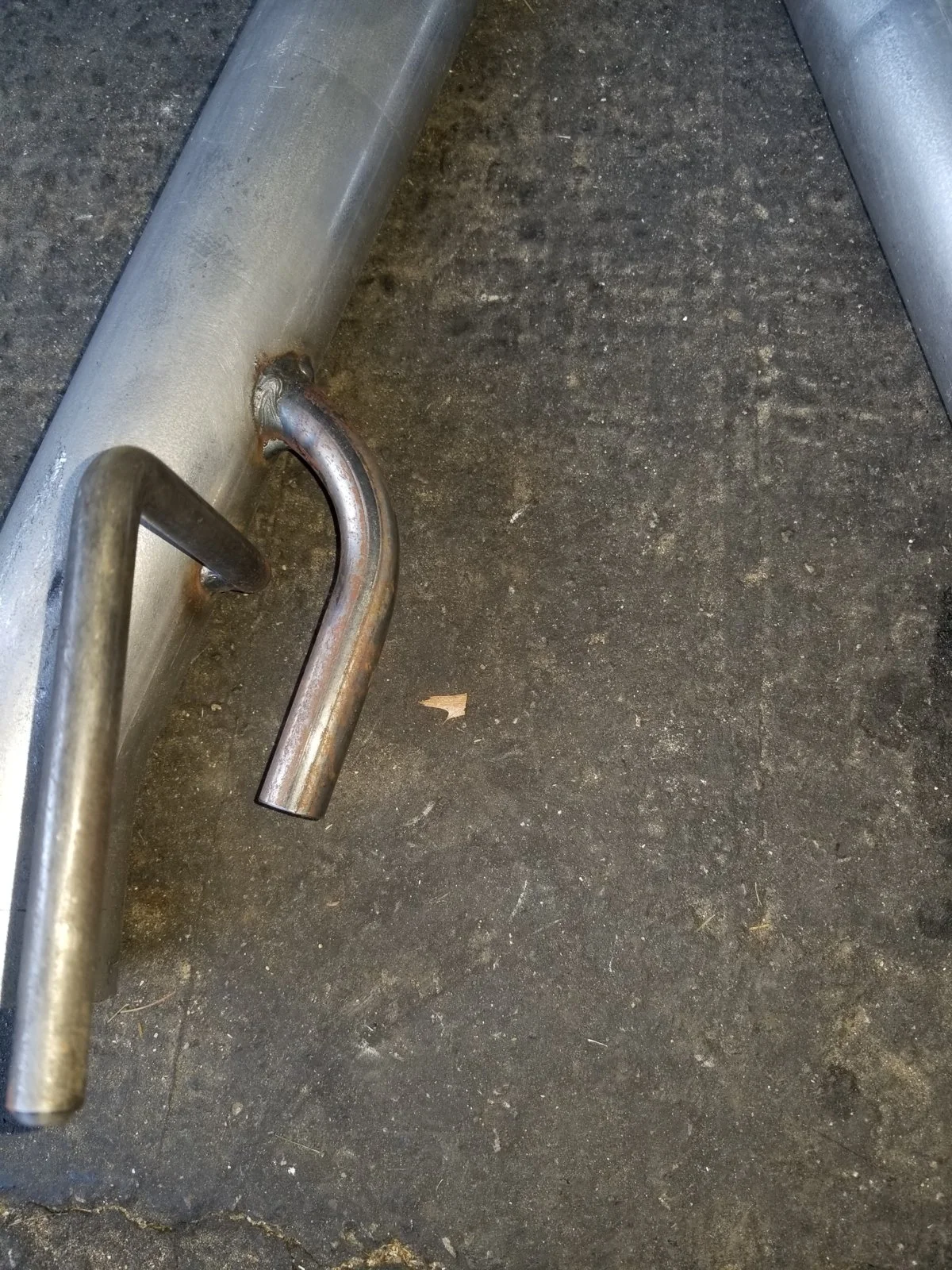

I know you guys have the answers for this one,why does the old x-pipe not have one of these????
Well other than no pic, what is the h pipe off of?
Thank you gk, there is no smog pump on engine, I'm replacing an old bbk x pipe with a new bbk h pipe.what are my options...Well other than no pic, what is the h pipe off of?
Opps, there it is.
thats for the air pump
Opps, there it is.
Hate'n them hoes clamps!
There is no stuff at other end! Lol!3/4" heater hose, bolt to stuff in other end, two hoes clamps, and call it a day
Did I order the wrong pipe?There is no stuff at other end! Lol!
I just cut mine off today, and just welded the hole closed.I know you guys have the answers for this one,why does the old x-pipe not have one of these????
