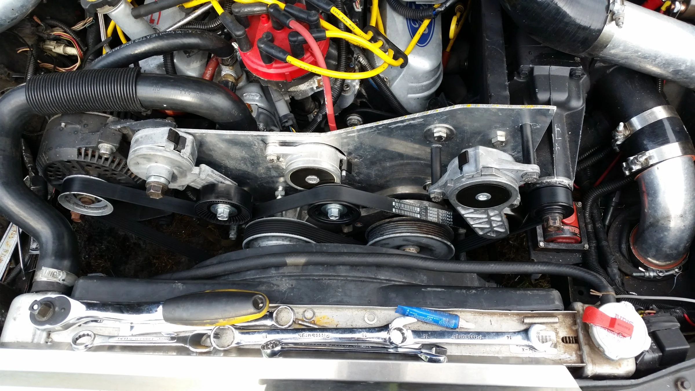

Wow man, that is crazy. I'm SURE that took some work!
Anyway, that Dayco pulley looks exactly like mine, and funny thing is that the Advance Auto Parts store I went to earlier has it in stock. Guess that is where I am headed.
Everyone, thanks for the help! Looks like I'll be all set tomorrow.
