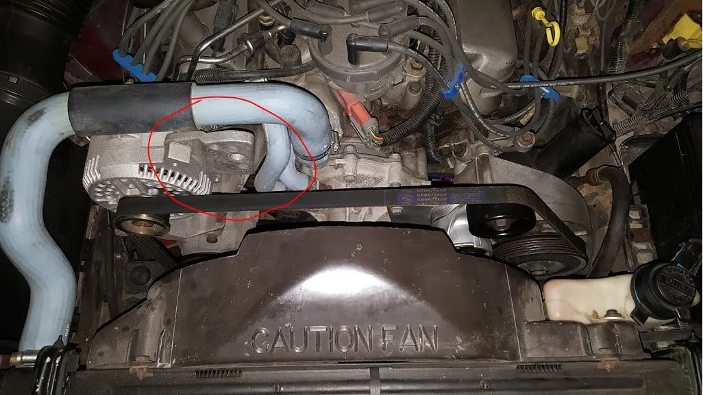

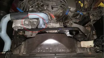

I'm not sure what issues @Foxybody95 has had, but I ran my tensioner in its original spot on two different a/c deleted foxes for more than 5-years apiece with zero problems. If your tensioner is making contact with your water pump pulley, then you have the wrong size belt on there. There is no additional stress being placed on the water pump pulley. The tension on the pulley isn't changing a bit....only its location.
As you can see by this photo, the tensioner is nowhere near making contact with the power steering pump pulley.

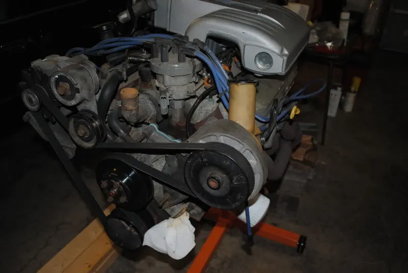

Granted, this engine has under drive pulleys, but the difference is nil. This is a factory non a/c set up (or the Ford Racing A/C delete). That's the ONLY way to simply and effectively remove the compressor from your car. I have the one removed from mine for sale if anyone is interested?
Also, all of the smooth idler pulleys on the later cars are of non-grooved design and it never seems to pose a problem. As long as the pulleys are properly aligned, they'll center themselves.
