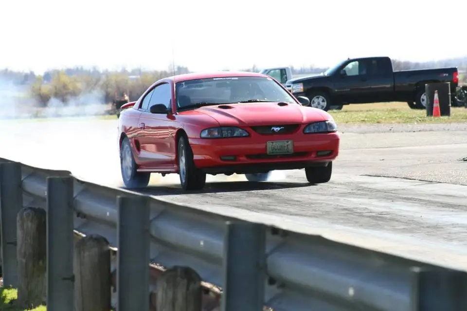

Knocked another tenth off and beat my 07 time.
R/T - .1199
60ft - 1.9010
330ft - 5.2915
1/8ET - 8.1456
1/8mph - 85.98
1000ft - 10.6360
1000mph - 98.38
1/4ET - 12.7295
1/4mph - 107.76
My 07 N/A best was 12.77 @ 106.66. That was the first new engine, 3.73s, and D/Rs that were an inch shorter than the POS street tires I was on Sunday. Plus no hickup in 2nd gear like I have now.
Ran a 12.83 @ 108.25 on the first run of the day Sunday. I switched wheels with my g/f's 95. Now I have her stock waffle wheels. My car looks like poo.
