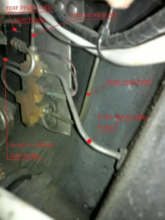

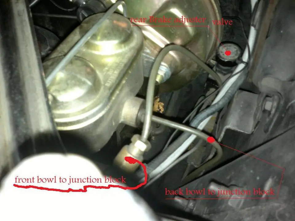

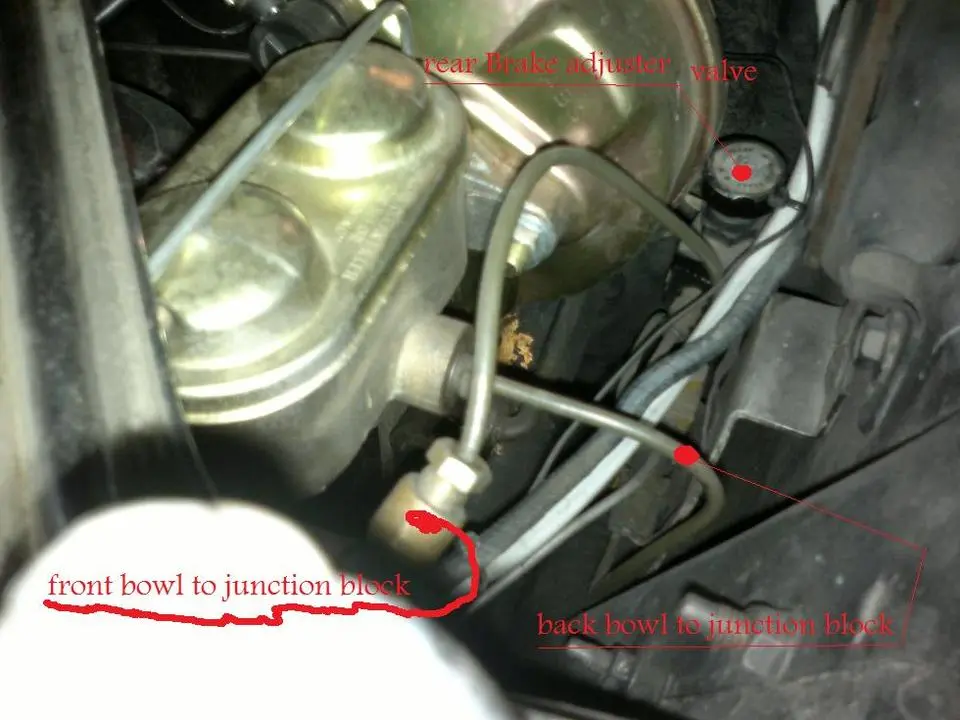

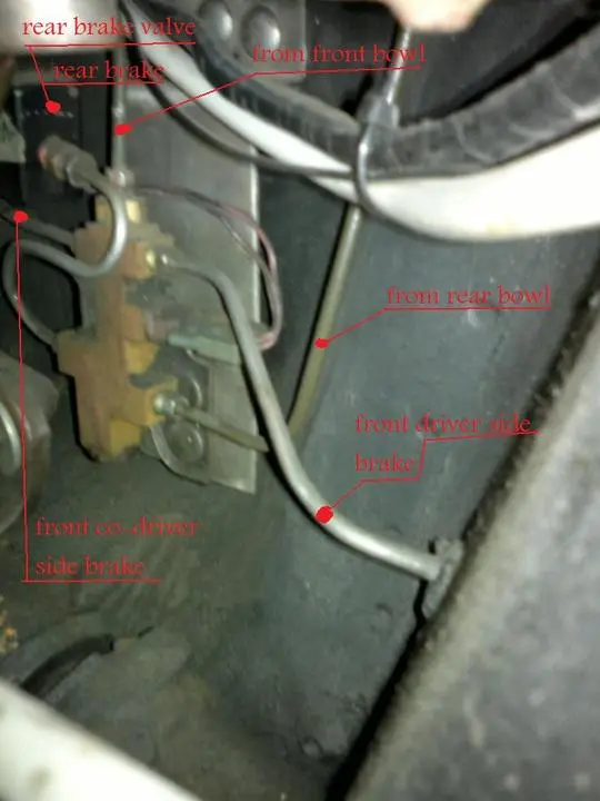

Alright, i have taken a look at my brake system:
In the first picture you see the master cylinder and the adjuster valve for the rear brakes. The brake lines go direct from the bowl to a junction block - see second pic. On the junction block are markings which line connects on the right spot on it. In my case the front bowl goes to the rear brake entry port and the rear bowl goes to the front entry port from the junction block. There are three outs from the junction block:
One to the drivers side brake
One to the co-drivers side brake
One to the rear brakes - the line goes to the rearend where it is splitted with a tee to the drivers and co-drivers rear brake side.
As i already said, the car was equipped with this setup as i bought it. I only upgraded from a manual to a power brake system. It functions very well and the manual master cylinder was connected similar to the junction block as it now is.
Hopefully a more experienced user will join this thread to confirm 100% that this is the correct way to plump it all in, but i never saw it any different from other stangs in my area.
