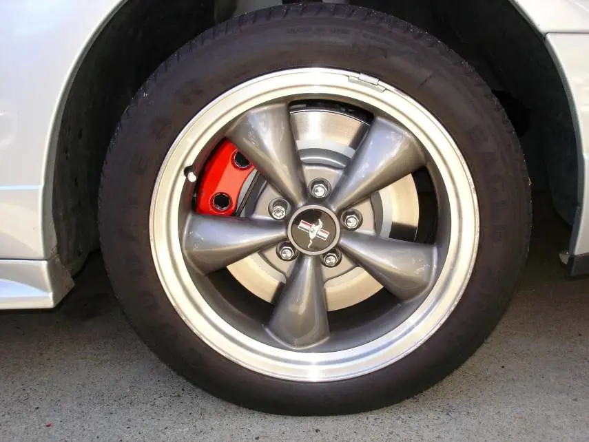

I got my kit from buyfordracing.com
http://www.buyfordracing.com/shop/product_info.php?products_id=594
It was $340 shipped with stainless lines.
I painted the calipers red since the plain calipers were too plain for me.
As for the rear, go with Brembo rotors out back. They are $34 each from tirerack.com.
http://www.tirerack.com/brakes/resu...Year=2003&autoModClar=&brand=&category=Rotors
For pads, unsure if PBR makes rear Pads for the Mustang considering the rear calipers are made by Varga. You might have go go with Motorcraft OEM pads. I wouldn't run cheapo parts store pads or they will squeal, even with proper anti-squeal lube. Been there, done that.
