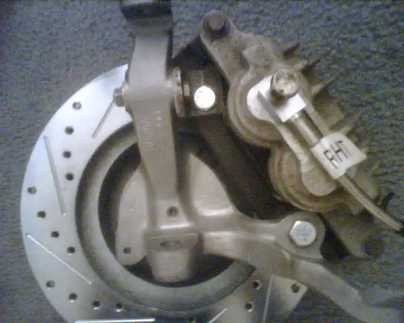

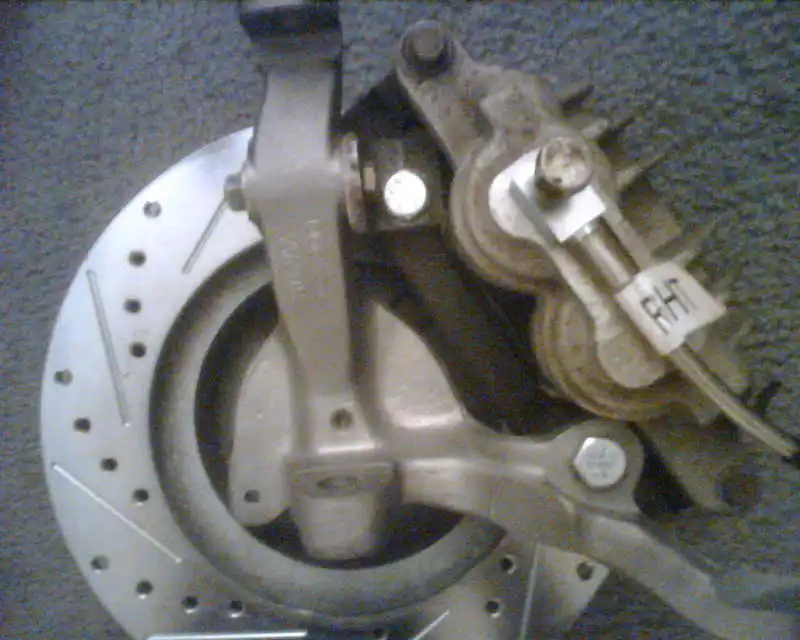

Well, finally got the bug and decided to put the shoulder to the wheel on my 66'. Its been sitting for awhile, awaiting a front end rebuild, as the brakes (original drum brakes) were pretty bad, and the bushings along with everything else....it was just unsafe to drive!
So, a few hundred bucks at the local mustang shop, i've got one side rebuilt to stock with new ball joints/bushings/bearings.
I decided to fab/gather the necessary items to swap on these PBR twin piston calipers i picked up from the junk yard for cheap. The plan was to put them On to some Granada spindles i also sourced at the junkyard (what can i say im cheap!!)
So, a little prep work and paint, and it looks like i spent a bundle! if i had to round out the price chart, it went something like..
Calipers/brakets 60$ (for both)
Spindles (which came with the old calipers) 60$
New spindle bearings...something like 20$
Paint 10$
New cross drilled/slotted anodized rotors...i think i paid 125ish awhile ago for those
New brake lines 85$
New pads 25$
---------raw materials for swapping calipers onto spindles
10$ for the angle iron
15 $ in random grade 8 bolts and washers/nuts
a few bucks in drill bits...
So, for about 400$ i have a nice brake system system
For the other 300$ or so for the front end rebuild
700$ total (doing the work myself), i came in quite abit ahead of some of the
"bolt on" setups you can purchase out right. And i can say "Hey man, i made that!"
anyways heres a couple of pictures, take part in my moment of glory, haha

I can snap a couple more in a day or so. Anything in perticular you want to see? This takes basic fabricating, Infact, it took longer to locate the materials (bolts and such) than it did to make the brackets.
I would highly recomend having access to a drill press though.
I drilled mine with a hand drill .....1/4 metal is not fun to drill through... a number of burnt bits told me so!

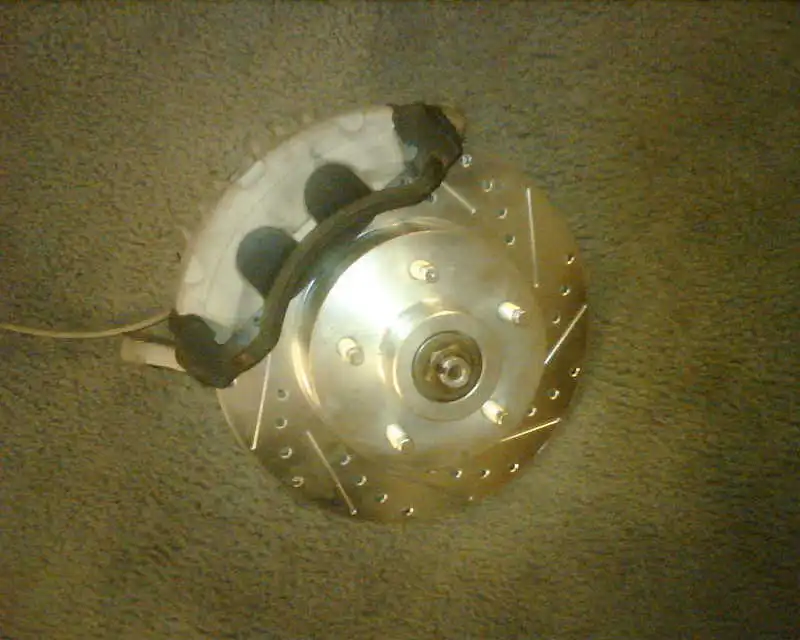

I chimed in on here a few months ago, said I was working on fitting 13" rotors to Granada spindles.
First off let me say, if you have the means to do this yourself then go for it otherwise it isn't worth it to pay someone to do the machine work. I did some bartering with a local guy who turned out to be a machinist and cut me a great deal. For the going hourly rate for this job he told me he would have charged me $700. I loaned him my Eastwood fender lip roller.
Originally I though I could use the hub the same way the MustangSteve kit works:
Link
The Granada rotor has a longer body that the vintage hubs so running the 13 rotor over the outside of the Granada hub would have required very long bolts or the caliper mount. This would have put dangerous force on the ends of these two bolts during braking. I even thought about using components of a Wilwood Mustang II/Pinto big brake kit that use a hub that would fit on a Granada spindle. That was way too expensive and not as fun as doing it myself.
Started with new Granada rotors, I wanted to make sure I was getting a pair of fairly equal thickness hubs coming from the same factory.
Marked for cutting
After cut
Raw hub
Hub Machined; center cut down and flange smoothed and leveled
Center bore of 13" rotor also machined to slip over the inner wheel bearing shaft
Slip fit; putting my absentee ballot to good use, didn't want to scratch the linoleum in the kitchen while the wife was away.
1.5" spacer
Here's how I bolted the spacer on, I started with a 1.5" adapter with press in studs. I pressed the studs out and am using longer Grade 8 studs, Torque the spacer to the hub/rotor using the recessed holes and the stud extends beyond the spacer allowing for the wheel to bolt to it.
Test fit 17x9
1" flare needed
Mock up of the brakes, the image is slanted, didn't level the camera

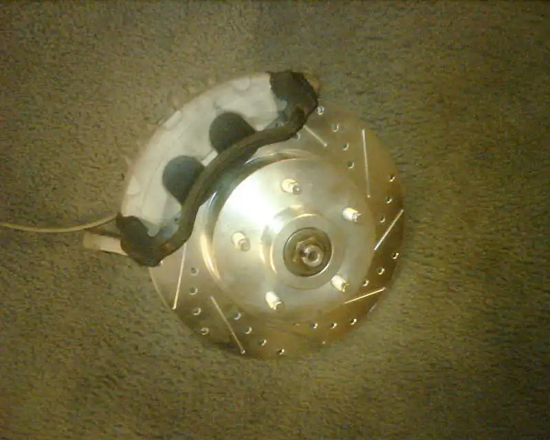

Link
Marked for cutting
After cut
Raw hub
1.5" spacer
Test fit 17x9
1" flare needed
