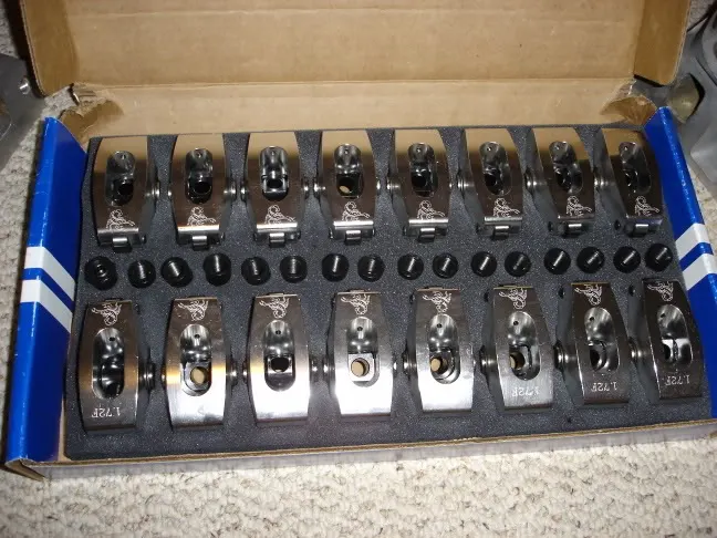

soooooo finally got a set of heads i think i'm going to stick with. Since i had to switch to stud mounts, i ordered some scorpion 1.72's with them.

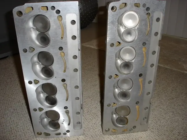

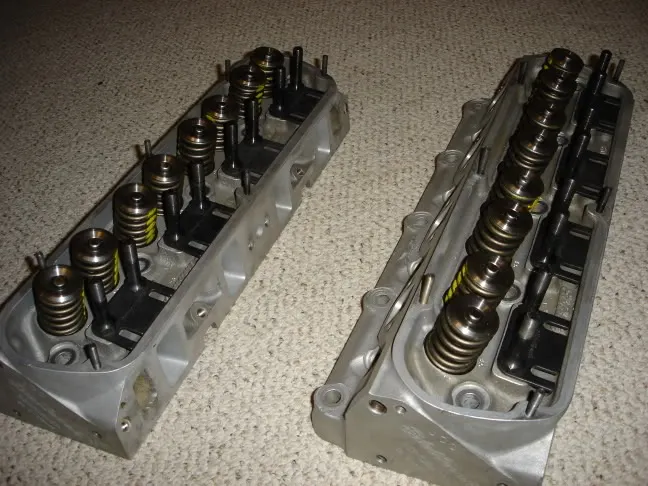

Specs on the heads:
Edelbrock Performer RPM's---CNC ported and milled to 57cc.
2.02/1.6 valves
Triple valve springs
ARP head studs
valve job
Titanium retainers
10* locks etc

Here are some pics btw:

wytstang said:
With the E cam around 290rwhp +/-, with those heads I would look for a better cam. Those heads need a better cam to really perform the way they want to. Good luck...
Yea i know what you mean. I deff thought of that, but i jus can't go through the trouble and of switching cams every time i switch heads. Maybe in the near future if i'm not happy with it, but with those scorpion 1.72's i will be getting .540 lift on intake and exhaust so it shouldn't be too bad. I saw some user combos on the sticky running these heads in stock form (no port work) and a 2031 with an RPM intake making 310whp without all the bolt ons. So with a good tune i'm hoping for more than that.
Are those the newer heads or the old school ones?
My friend made 323rwhp with the newer ones (1.90 valve) on a 306 with a comp 270XE cam, TFS street manifold, 70mm tb, 30lb injectors, shorty headers. Heads had some bowl work, they were milled and had good springs.
Be sure to check p to v clearance with those inline 2.02 heads.
Welp heads are already on the car. PVC seems to be good.......clears really well. Just have to fiddle with adjusting the rockers a bit more and then i'll post some vids and pics.................my friend has a Nikon D50 SLR camera so those should turn out sweet. Can't wait.
