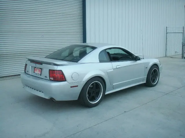

Rear wheels are 275/45/18. Same with the front. Wheels are 9.5" wide.

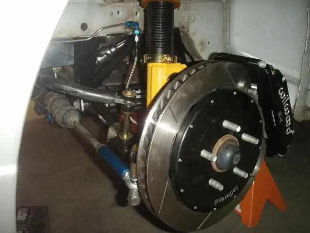

I installed some of the stuff from the MM Max Grip Box I have and F'ed up and forgot that the Wilwood Superlite 6 Big Brake kit won't fit the stock wheels I have in the car so my friend Rodger let me use the 18's he had in his car.
Here's a picture with the 18's on after I installed the stuff on my car.
I think that when you black out the center it makes the wheel look smaller. The rear looks fine width wise and with the stiffer spring rates tomustang is right. The 20's would be destroyed the first time you hit a pothole with the lower profile tires so I think I'll stick with 18's. 9.5's in the rear with a 275/40/18 and 8 or 8.5's 245/45/18 in front. Not sure if I'll go chrome, brushed or blacked out. What do you think?
Those aspect ratios are much too tall. Depending on the brand/drop lowering spring you're using, a 45 on the front and a 40 on the rear will tend to scrub the wheel well frequently.
On my way to work, there's a certain right hand "sweeper" turn that, at 70mph, will always scrub my driver's side rear wheel well. Keep in mind that I have a 30 series tire on the rear too, although I'm running H&R SS springs.

I'm going to run 18's but I want to fill the well. The 18's on the rear are fine and even under hard cornering don't rub so I think I may stick with those but I'd like a little less sidewall maybe a 1/4 to 1/2 inch less. For the fronts I'd like to pull the backspacing in a bit so that they tuck the fender and not go with such a wide tire for better turn in. With the widths that I listed what would be the best tire setup?

I'd personally go no larger than a 35 series, front and rear. I have a 35 on the front and a 30 on the rear, and I still scrape the driver's side, front and back, on hard right sweeper turns. If you're not into corner carving, then you may be "ok," but a 45 is surely too tall. The 40 might work, but the 45 should not even be considered.

Hypercoils. 450 in front and 350 in back. Mind you, I still have an inch adjustment down on the LCA pick up points on the K-Member and the coilovers are adjustable so I can lower the car that way too although right now the bumpsteer feels just right so I'll probably stay with the Front LCA height and coilover height I'm at!

Well that really is up to the width of the tire.
You can't just generalize sidewall size like that.

The plan for the tires is BFG KDW's rear 275/40/18. The ones I have on now are 275/45/18 and work well and don't rub but they look a little tall in the sidewall so I think 40 series will work. If not then 35. Front 245/45/18. The ones on there now are a bit wide and stick out of the fenderwll about a 3/4 to an inch. I want to tuck them so I think the 245's should work out nicely! Thoughts?
