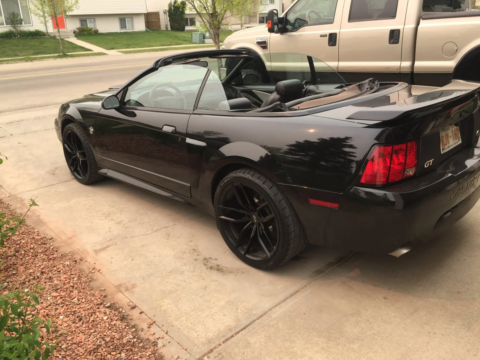

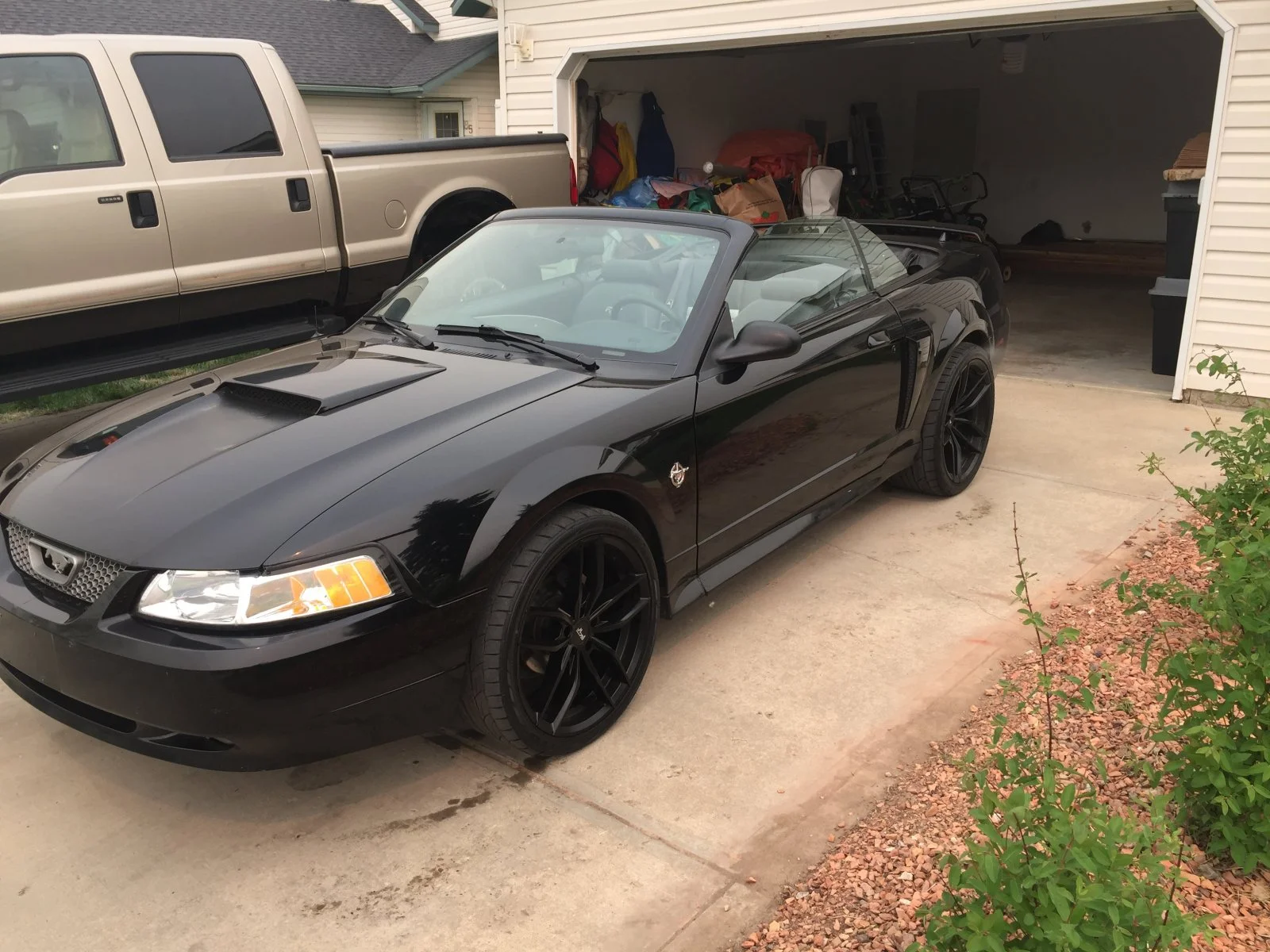

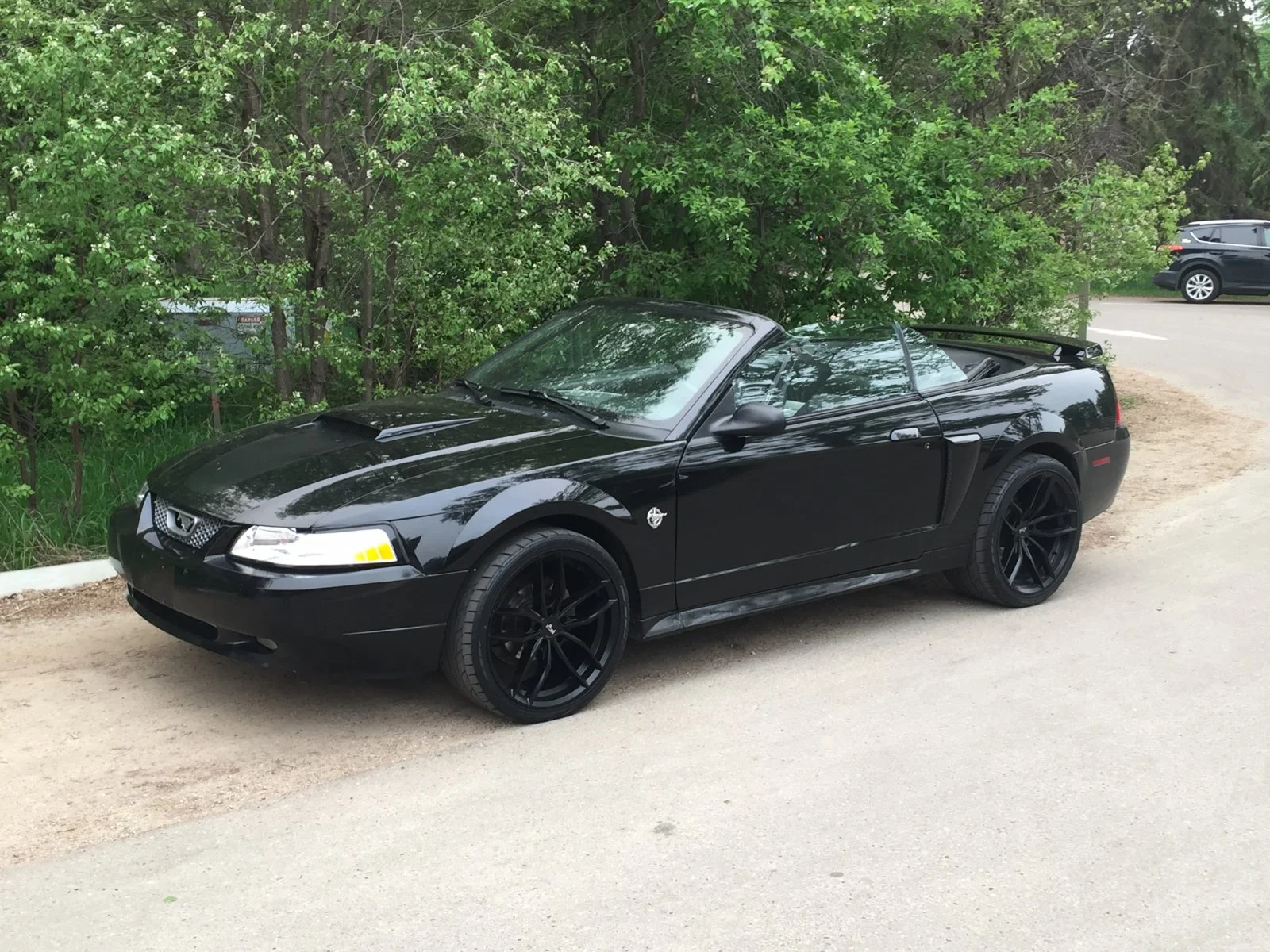

I know that this thread is as old as dirt but it’s one of the first ones that pop up when you search for new edges with 20’s
First time posting but I have been creeping for a little while. While it seems to be the common opinion that the max rim size is 18” for a new edge mustang (I completely respect that opinion), I think it can be pulled off. Normally I wouldn’t post any of this but there are not a lot of pictures of new edge mustangs with 20’s on the internet, so it makes it even tougher to pull the trigger on a set. I had these put on last week,
Fronts
20x9 +25 offset. 275/30r20
rears
20x11 +20 offset. 305/30r20
gonna have to roll the rear fenders as the rear tires are getting struck by the inner lip of the fender. I ordered some Coilovers this morning to help stiffen things up and lower it down a bit to eliminate the wheel/fender gap. Let me know wheat you think
