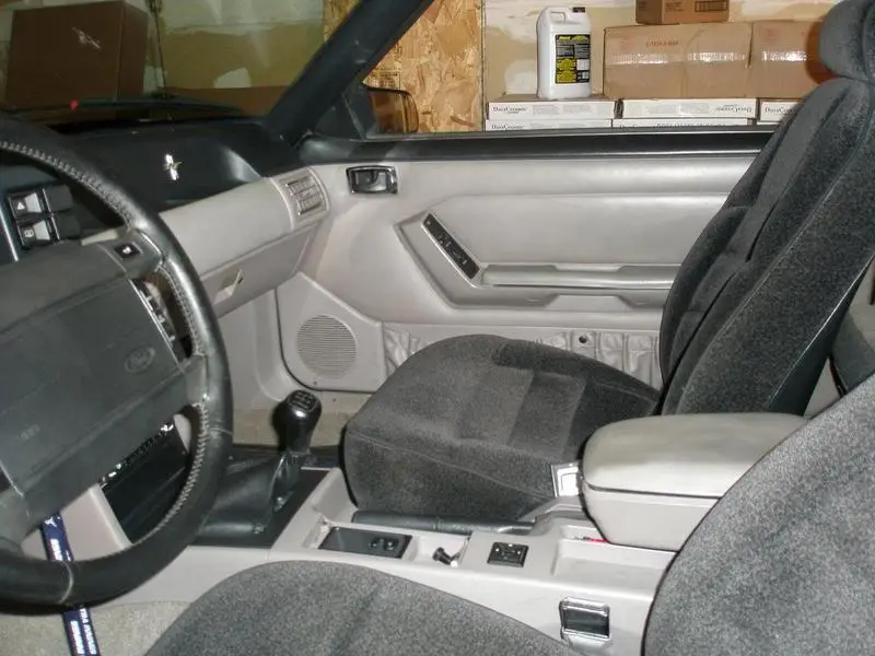

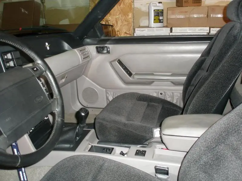

Here was an old shot of the 98 GT Seats in my 92 GT, they bolted right up to the Stock Tracks. I did not care for the slight color difference or the extra height of the Seats.

I agree the height I could do without, but the seats are way better than stockers.

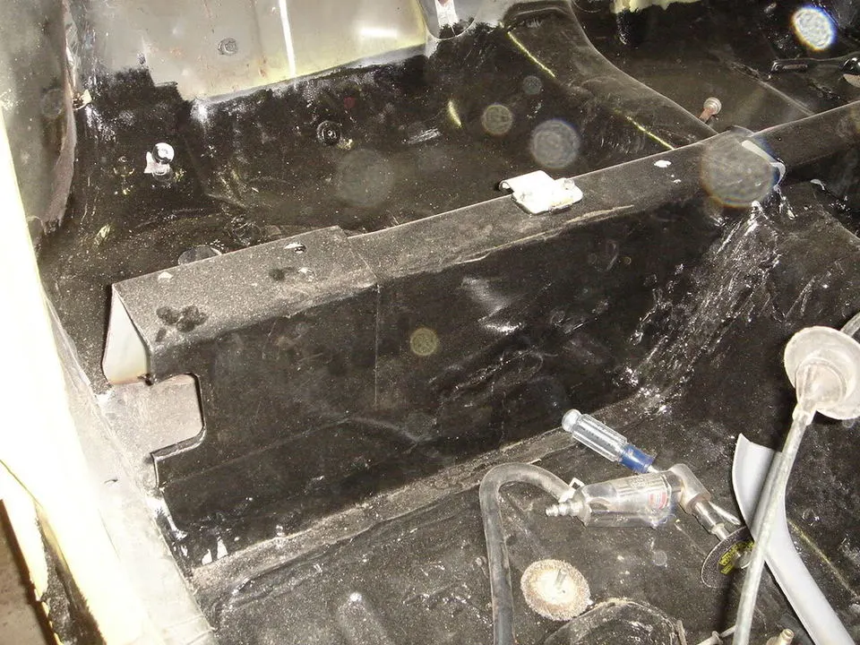

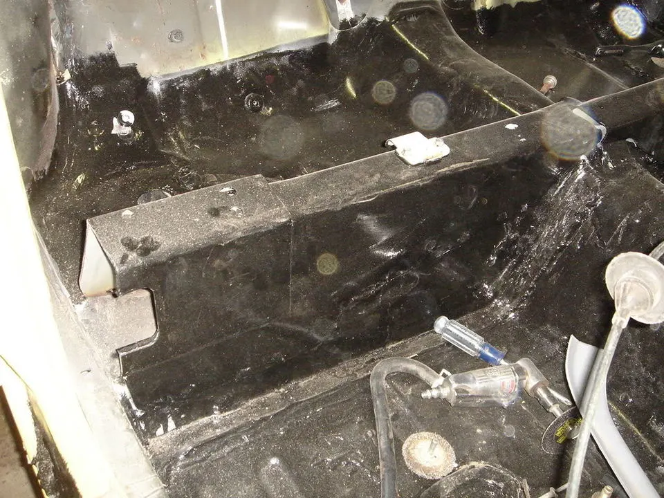

I mocked mine in on the 81. I welded the 94-04 brace in my notch. This way I can use the 2001 lower seat bottom. I am using the original 81 upright back seat, I am just getting it recovered. Now, the brace was a TON of work, and unless you have a donor car, you cannot get this. Others have shaved the foam off of the newer back seat bottom and got it to work. You can't use upright back seat because it isn't long enough. You will have to get custom filler panels for the sides.
Here is the brace..
