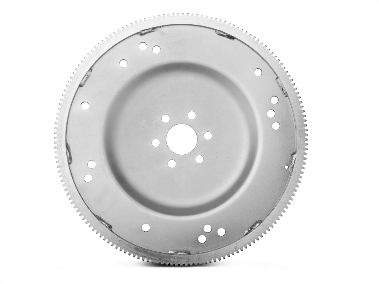

New "upgraded" flexplate (https://www.americanmuscle.com/sr-flexplate-6bolt.html)

Heres a picture from the inspection camera. Not sure what that straight line is, if its a crack, cause its all one piece.. Im fairly sure its a crack. but Ill have to get my finger on there tomorrow (and the camera).
Picture of Line or maybe crack on flexplate:

Heres a picture before install:
View: https://drive.google.com/open?id=1E0wuP6J321NCkTEFZCYU07ux26gqcR2b
Heres the product link/pictures you can see both sides, one piece:
