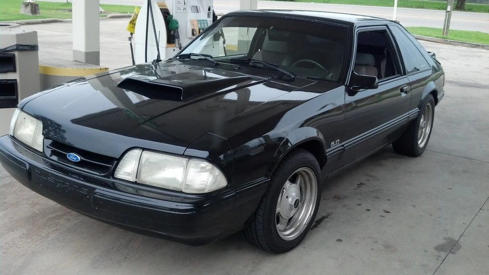

I haven't purchased it yet. What do you mean branded title as in wrecked??
Car checks out pretty well. Motor was rebuilt 50k miles ago, has only been to the track once since then. Oil changed every 3k. Has new plugs and wires. The only mods are BBK CAI, BBK headers, BBK H-pipe, flowmaster cat back. Fresh paint job 8 months ago to black. Needs some interior work, 25 years of wear and tear.
Reactions: FoxMustangLvr
Yes branded is another way to say salvaged/wrecked. People will lie and say it's clear and then you show up and it's another story after you fall in love with it (happened to me).
The car (from only looking at a picture) looks like it has an OK single stage paint job. Things to consider.....Did they properly de-trim the car when it was painted? If they didn't remove the rear quarter windows then the paint will flake off soon and leave you with needing another paint job. Look at the LX trim on the sides and see if the paint flows cleanly under them (means they took the molding off) or if you see where paint is filling the trim to panel gap that means they left them on and it will peel off soon too. Look through the cowl to where the windshield wipers are and look for over spray, if the car was not originally black you might find the old color still visible in there.
Looks like a clean car and I hope you will give it a good home it deserves. :nice:

Well I definitely not getting it if its salvage title. Bank probably won't finance me(only reason I'm financing is to build credit, I have no credit. Good or bad) The trim is actually peeling just a little on the edge of the door. Not sure how normal that is. It is definitely black underneath. I'm assuming they didn't put them back on correctly? You can definitely see the old color. The engine bay and around the bottom of the hatch lid shows red with white primer covering most of it. Definitely would have done it differently if it was me.
Their is a tiny spot of rust on the inside of the hatch, on the back left. Any advice on that?
the rust you describe doesnt sound bad, sand it off immediately though so it doesnt spread. while your at it check the bottom of the doors,floorpans, torque boxes(where front bolt of rear control arms attach to the body) for rust and separation of the metal. if all of those are ok and title is really free and clear, then go ahead and buy it. just please dear god take that hood scoop off!!!

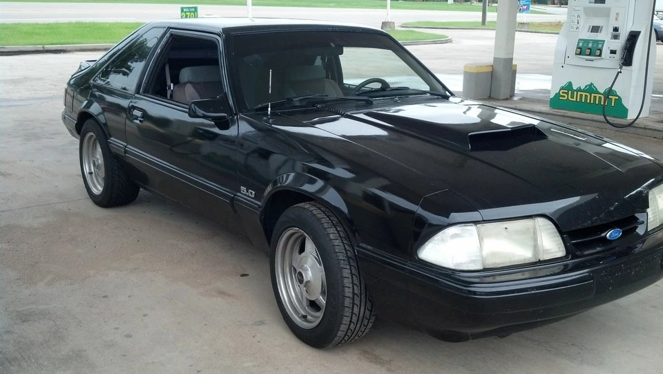

What grit and type of sand paper? The hood scoop....lol not a huge fan myself...but a new hood is $500. Maybe find a stock used one :/
it looks like thats a stock hood with the autozone stick on scoop. should pull off. just go slowly to not mess up the paint. as far as sandpaper start off heavier grit to remove the finish with a finer sheet to make smooth. dont know exact grit number,but there are plenty of talented people here on bodywork that may chime in. I am just smart enough to not attempt bodywork and leave it to professionals
