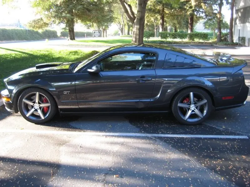

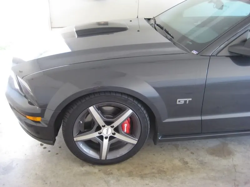

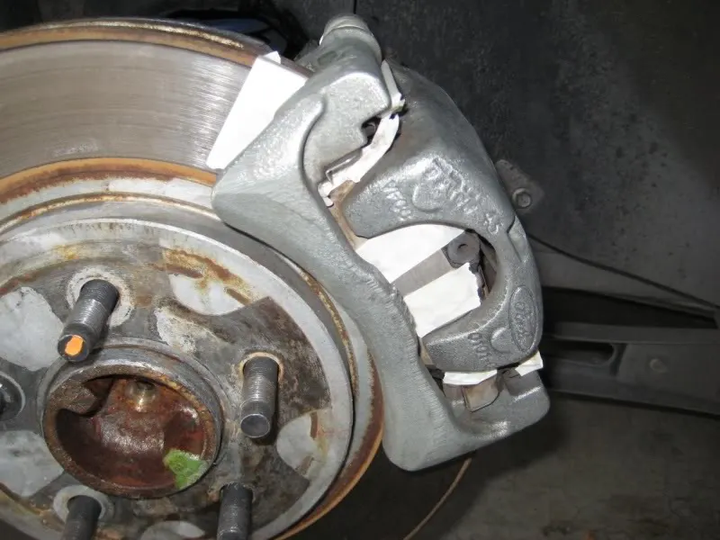

Hey fellow car nuts, I just upgraded the front brakes on my 07 Mustang GT to the 4-piston Brembo brakes that come on the Shelby GT500. Larger rotors and larger calipers = better stopping power. It never ceases to amaze me how many people work on making their cars go faster, (engine and suspension upgrades, etc.) without also upgrading the ability to stop the damn thing.

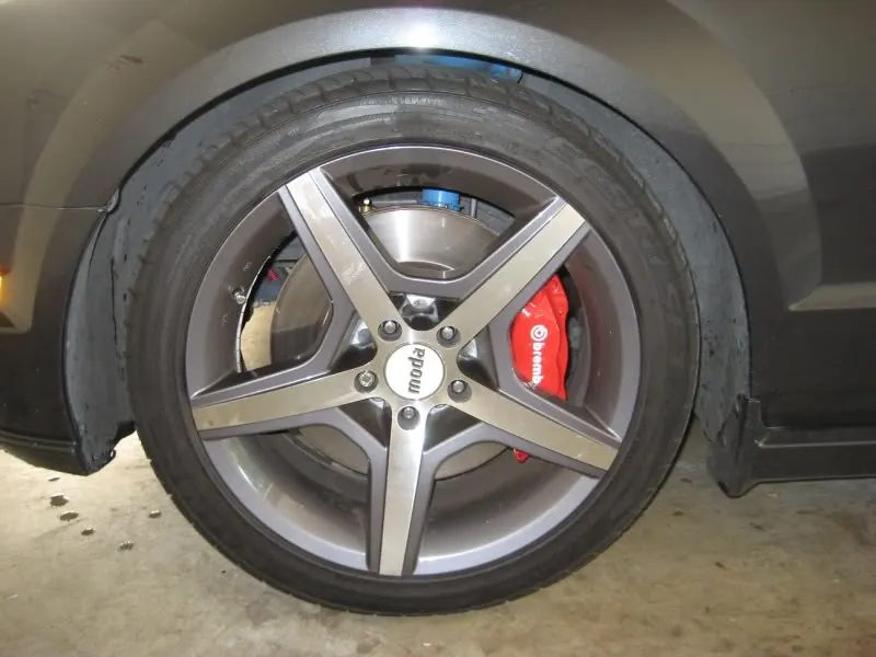

Since the Brembo calipers come powder coated black and my car is already so dark, I decided to paint them red.

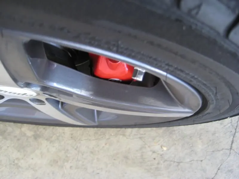

Check this out, there is barely enough clearance between the caliper and my wheels. My passenger side caliper showed a tiny bit of wear where the rim was barely scraping the caliper. I ordered some wheel spacers today to help that. Yikes.

The Brembo fronts definitely make a noticeable difference. Not huge, but noticeable.

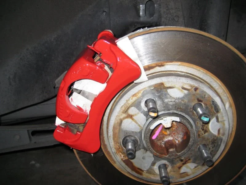

Rear caliper after cleaning with caliper cleaner and Simple Green. I sanded it a bit with 200 sandpaper.

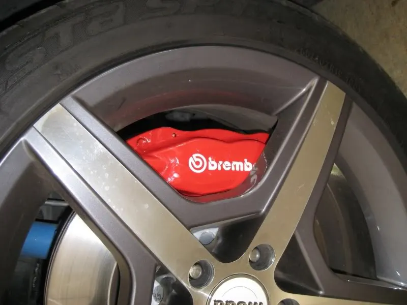

Rears painted.
