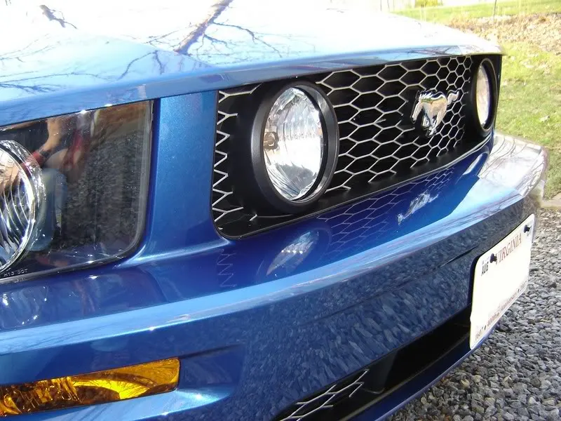

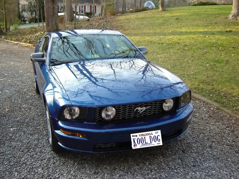

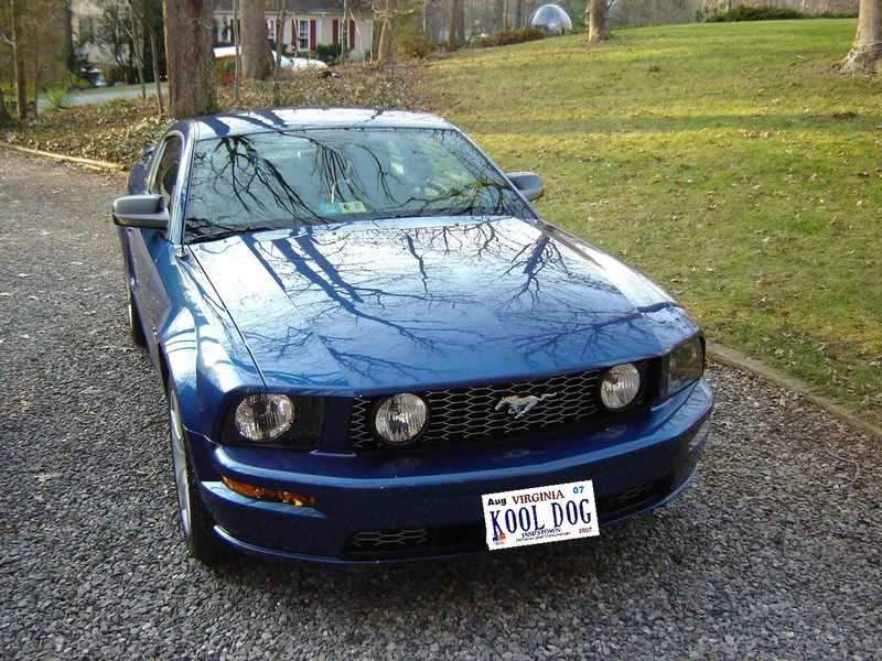

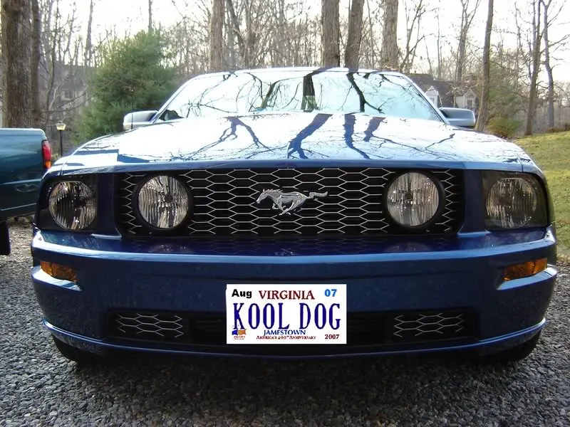

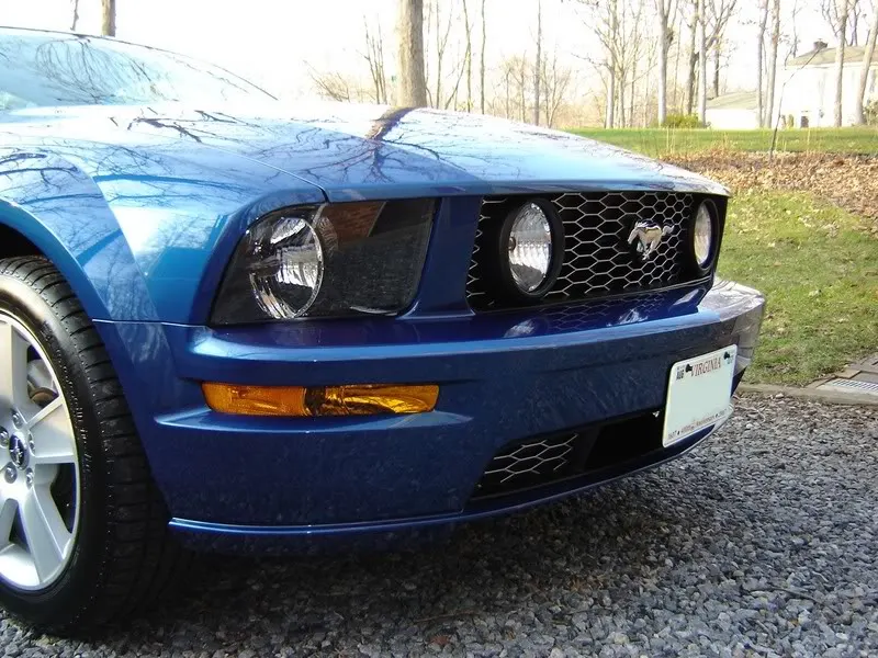

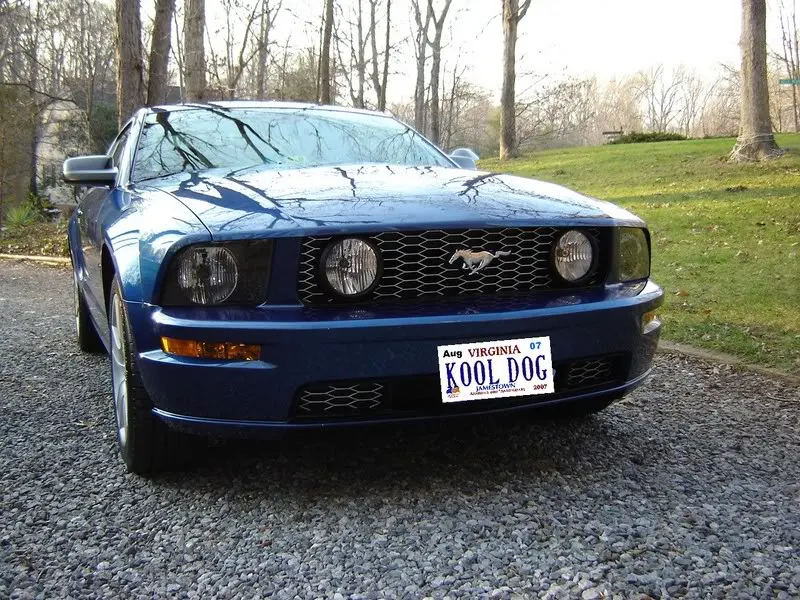

Well it took me a little longer than I thought to snap some pics during the day of the painted stock grill, but here she is...

I recently removed my stock fascia with the CDC Aggressive Chin Spoiler. The chin spoiler was 5'' from the ground which was too much BS for me. I replaced it with a Street Scene Generation 2 front fascia.
The Street Scene part is decent quality urethane. I've seen better, but I've also seen much worse. It took a few hours to prep and prefit the part. I had to add some high density foam rubber to the bumper support beam in 2 areas to keep the fascia tight to the grill. I also had to do some grinding to the side bumper brackets (side marker lights attach to them) to make them fit the new bumper cover. My friend Rick Siegert (Inferno Designs) completed the paint work.
