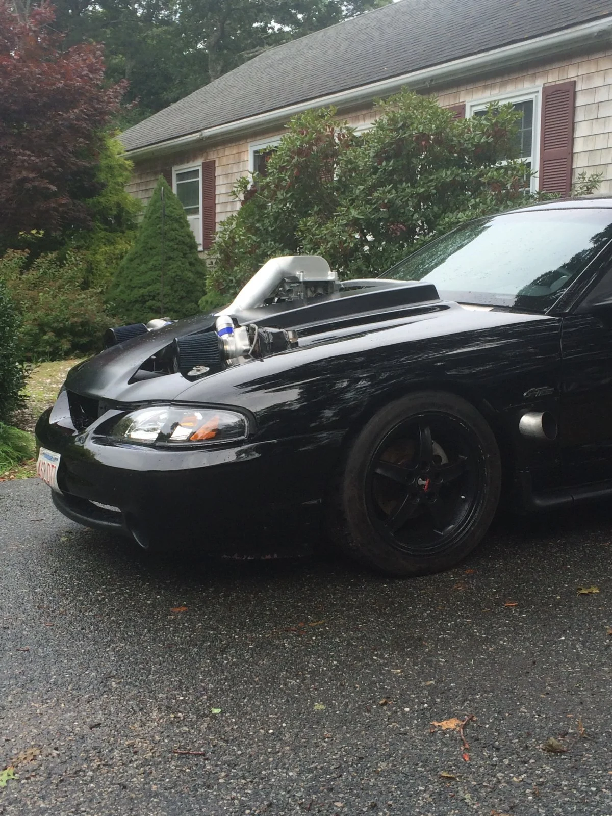

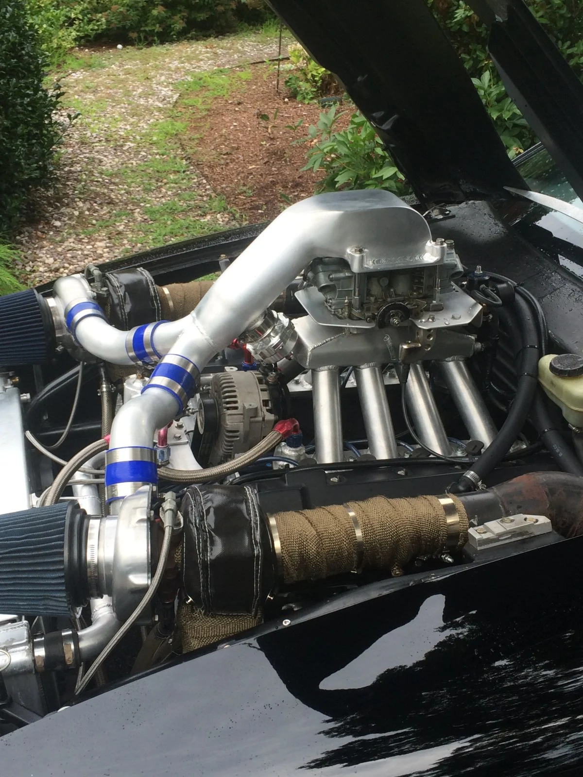

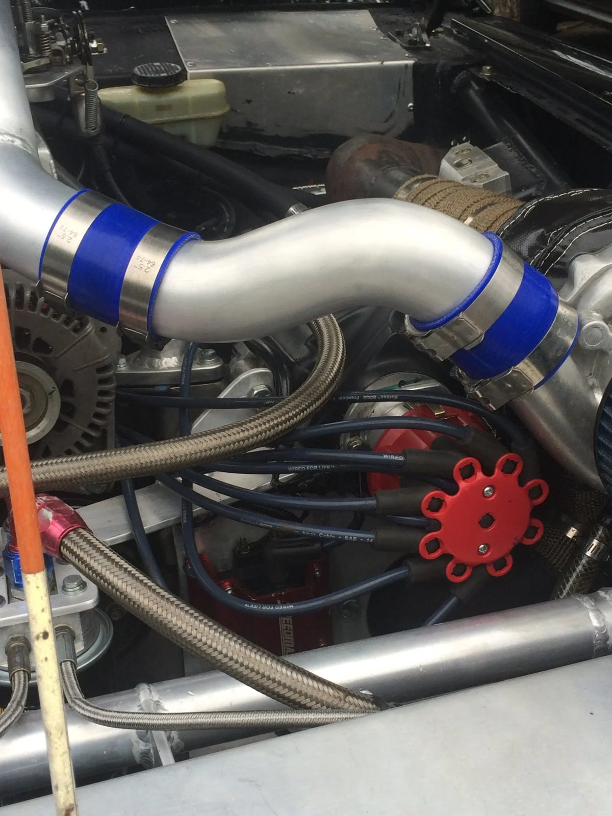

metal mike Member Apr 19, 2019 7 10 13 cape cod Apr 19, 2019 #1 Apr 19, 2019 #1 96 4.6 2v twin turbo blow thru holley carburetor and distributor is driven off cam and mounted in valve cover. all parts made in my garage. Reactions: Olivethefet
Olivethefet I will own your nuts! LOL 5 Year Member May 17, 2018 2,596 1,790 143 Enterprise AL Apr 19, 2019 #2 Apr 19, 2019 #2 That thing looks like a beast!
Noobz347 Stangnet Facilities Maint Tech... Er... Janitor Admin Dude Jan 4, 1985 43,422 21,629 234 Box behind Walmart May 4, 2019 #3 May 4, 2019 #3 What is the benefit of having it all mounted so high?
