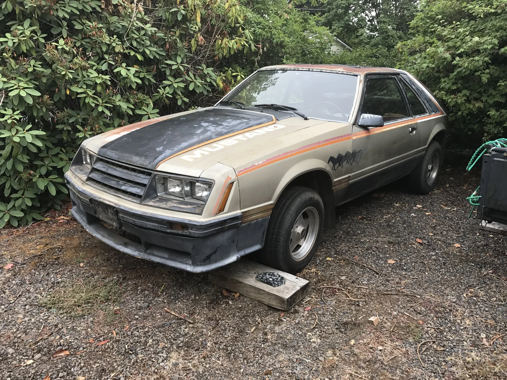

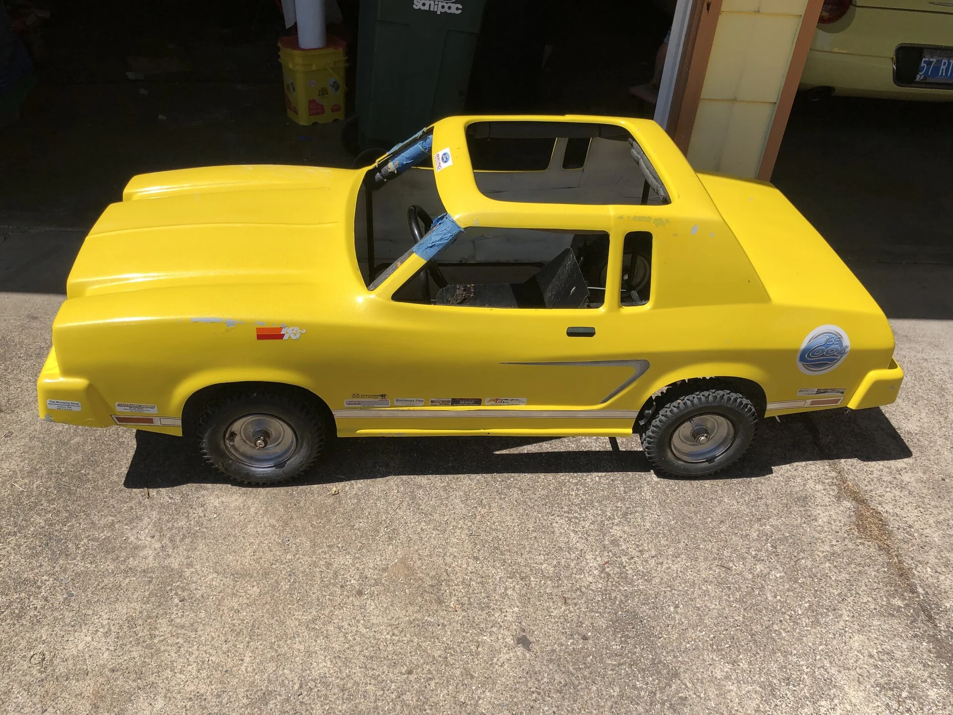

Hello from Oregon. Yes, it's raining today! I am restoring a 1979 Pace Car. Yes it is a true one with the "W". This was a rolling chaise only. Body and four wheels. Nothing but an echo in the car if you looked inside. So far I have purchased a 5.0L from a 91 GT, rear end and disc brakes all around from 95 Mustang and a T-5 transmission. I just found out the T-5 came out of a 2003 Mustang. The engine is a complete engine with the EFI system . So far the engine checks out just fine. Inspected the block and lower end. Oil pan was clean, heads seem fine. Just a little dirty from running cheap gas. I was going to convert the 79 to EFI but after finding out how much this will cost along with amount of work, I am considering swapping intake to a carb. Question: Are the heads compatible with a carb or do I need to change them? Look forward talking with folks. Sorry, I don't do Facebook or tweet. Larry from Oregon Oh yea, I have a Mustang II go kart....

Make sure you get a bellhousing from a 94/95 mustang if you don’t change the input shaft on the t5. You’ll need the clutch fork as well.
Yes the heads will work for a carb intake. They are the same.

If you want EFI for less $ and hassle, a Holley Sniper TBI EFI and an Edelbrock Airgap RPM Intake and matching cam would be a lot faster than the Pace Car ever started out. The air gap intake would also be great with a carb after you check for hood clearance. The air gap intakes are impressive in testing and customer feedback for street and strip cars. I ran a performer 302 EGR on an E-7 long block (87 up roller cam block and heads) in a ‘79 before the air gap intakes came out and was pleased. I installed a GT type hood scoop on the 79 hood. I placed it for clearance and looks. I cut out the hood under the scoop for more clearance for the air cleaner if I later wanted a carb spacer or taller intake, and it looked like it belonged there. I ran the dual snorkel 4bbl GT carb filter housing (83-85?) and the stock dual cold air hoses and inner fender connectors. The 2bbl, single snorkel housing choked the engine over 4K RPM. The difference was obvious by sound and by seat of the pants feel.

Welcome to Stangnet. If the T-5 is out of a 2003 Mustang, then it's out of a V6 car. Those actually came with the World Class T5 (T5z), so nice score. The input shafts on those are longer, as is the bellhousing. Is it a complete setup with fork and bellhousing? The heads will work, but you will need to plug the thermactor ports on the back of them. That's no big deal. I don't recommend swapping a cam with stock 91' heads; there is no gain in it. I'd bite the bullet and get the Holley Sniper EFI as suggested. Carbs are becoming a lost art, and finding anyone that can dial it in right is tough. You are going to need to change the distributor and ignition system to run it with a carb. Not sure if the Holley Sniper EFI will allow you to run the 91' distributor, but I'm guessing it will. Keep in mind that the 91' engine is an HO, which has a different firing order than what came in a 79' car. Just for future reference. You just have to plug the wires into the distributor in a different sequence. Keep us in the loop. Looks like a great project.
