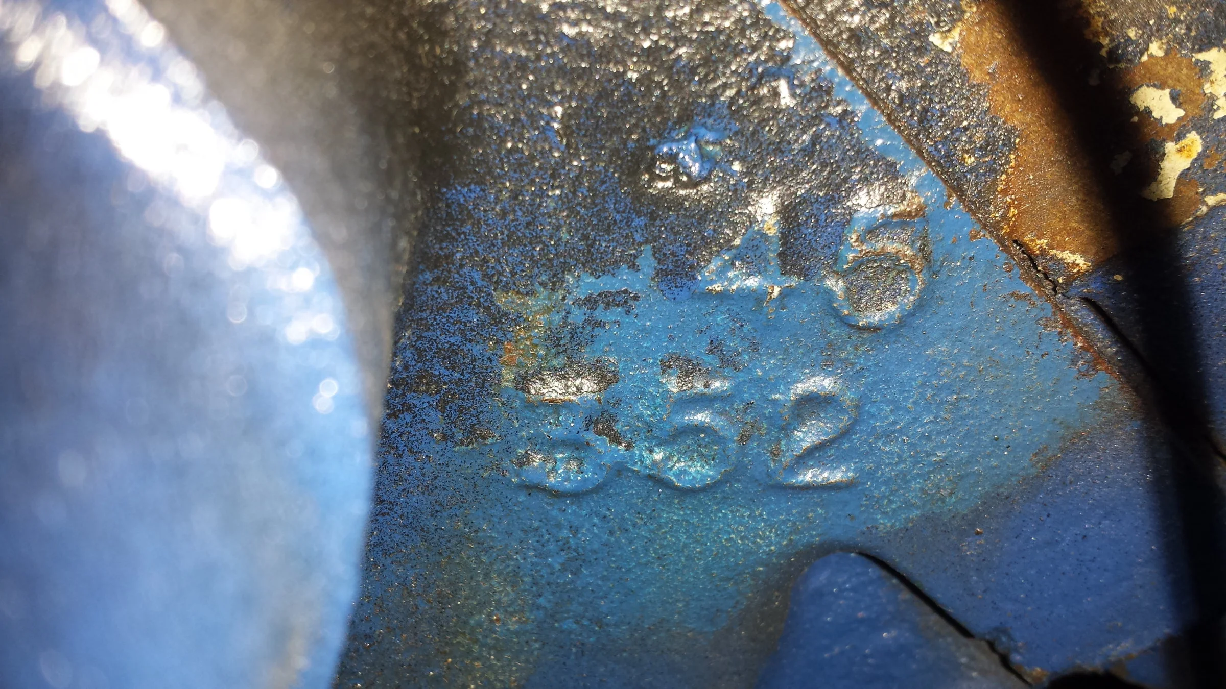

Have a 1969 mach I fastback / with date code correct 428 / r code . Looking to verify what i got and to find out some info on it want to see what i really bought was worth it or not . Its no barrett jackson car . But to me it is . And also looking for a mustang repair/restoration shop in the Nassau county ny area . Thanks in advance
Thanks . I have a r in the vin plate and door tag . Wondering about the engine . Just want to be sure about that. Was told its a date code coreect 428 cj. Not numbers matching. Other thing is trying to find value to the car .. and also would you know where power to brake pedal switch comes from have no power at the brake pedal switch therefore no brake light . Thanks for your time and help .
