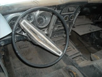

I would not alter the gauges. You already have the rare full-instrument analog cluster. Digital readouts look really groovy at cruise night, but they really suck for hard driving. You see, your peripheral vision can see the needles, so you can tell the condition without "reading" them. With digital gauges, you have to actually take your eyes off the road, and read the indication. Ask any pilot. We had all the engine gauges turned in our aircraft so that the needles were straight out to the side when normal. Some of them were upside down to achieve this.

B>Your gauge/instrument setup/package is already just about the coolest of the lot for that year, so stick with it, make it all work correctly and spend the corresponding saving$ on other more critical and/or fun/cosmetic/go fast issues.

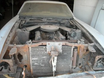

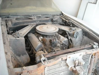

From the pics, I see there are already headers on the car, which leads one to suspect there may be other mods to the engine (possible cam/valve train, etc) so I would get it running as well as is possible with what is currently there for an engine and as long as the engine runs well, drive it like that through your other mods and THEN decide what improvements in performance are applicable for your use/driving.

the flappers are gone ATM you look off to the side in one of the pics you can see the hood
Ah, good eye, I had to follow the link to catch it. But I'll take a contrary view. Unless there is evidence that a plenum was once installed, I'm betting it never had ram air. Probably less than 10% of the scoop hoods had it, and since only the 2V could order it in 73, not many people cared about ram air on a 351 2V with single exhaust. You seem to be missing the scoop insert as well, but that's available new. The vast majority of scoop hoods had black honeycomb block plates inside the scoop. You can get these, too, if you don't want to spend the cash for ram air.
