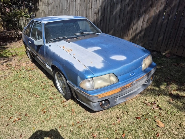

Hey there guys I am new but OLD. I have just got back into a Mustang. I bought a 1993 Mustang GT it's got good bones but will need love, been out of this end Mustangs were more into Mod motors. But now going backward wanting to build a 302 with decent power what's the best way to go? I will street and strip it and of course, drive it to the Chevrolet Dealership I work at.

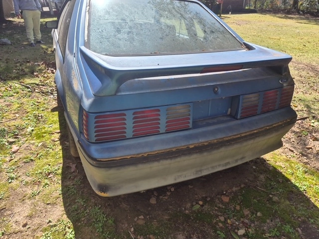

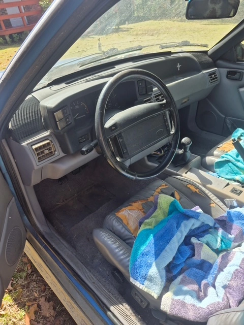

The vehicle has 78,000 original miles but has been sitting for the last 7 to 10 years, based on its exterior and interior condition. I need some expertise on the best way to restore it. Surprisingly, there is no rot; however, there is some surface rust, and the front fog lights have rusted out. Fortunately, there are no dents or dings. I purchased the vehicle from a lady whose brother passed away. He was the original owner and had plans to restore it. I want to proceed with the restoration while also ensuring that the engine is in excellent condition.
So looking for the best option for motor, trans and inside
BOUGHT IT FOR 3K --I HAVE A DECENT BUDGET I EXPECT 2K FOR INSIDE 4K BODY AND PAINT THATS DOING IT IN A BOOTH MYSELF ABD DRIVE TRAIN 6-8 BRAKES AND TIRES 2K

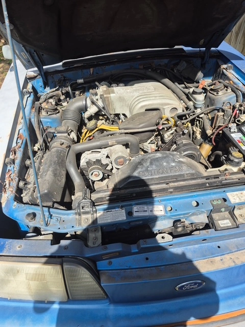

If it runs do a compression test and post up the results. If the numbers are low then do a leak down test as it may be the heads.
If the compression numbers are good the I would drop the pan and replace the oil pump drive shaft, oil pump, and oil pump pickup tube. From there I would either put a TFS kit on it (heeds, upper, lower and cam) or call Ed Curtis and have him spec it all out. Ditch the stock radiator and get a good two row aluminum unit. Your choice on the stock mechanical fan (if you keep it install a new fan clutch) or install an electric fan and whether or not you think the stock water pump is in good shape. You will need at minimum a 65 or 70mm throttle body and I would upgrade the MAF to a 75mm calibrated for some 30 lb/hr injectors. 24's might work but 30's would keep the duty cycle down low and the idle will be better. Upgrade the stock fuel pump to a 190 lpr and change the fuel filter.
I would also suggest you at a minimum go with 1-5/8" shorty headers, 2-1/2" H or X pipe, and your flavor of 2-1/2" cat back. That motor will need to breath.
No you should not need a tune for the car to run pretty well. Will a tune help? It won't hurt but it should not be necessary.
More than one way to upgrade the motor but if the stock short block is in good shape then no reason not to use it. You will make around 300 rwhp which is all kinds of fun in these cars.

That car looks like a decent start. Looks completely stock under the hood. The cobra intakes are ok but the gt40 tubular intake is even better. A ported explorer intake will do better than both of them though. Personally, I like holley systemax intakes but they cost. 300 - 350hp is fun in these cars. With more than that you may have to check your pants, every once in a while, for brown marks.
