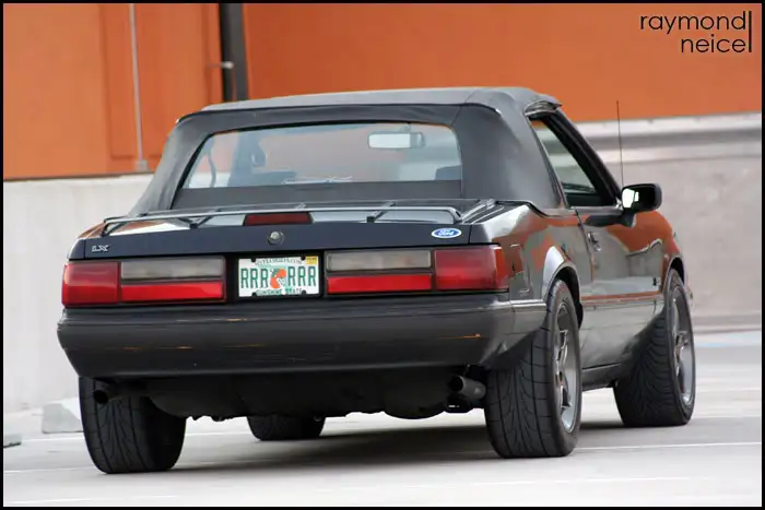

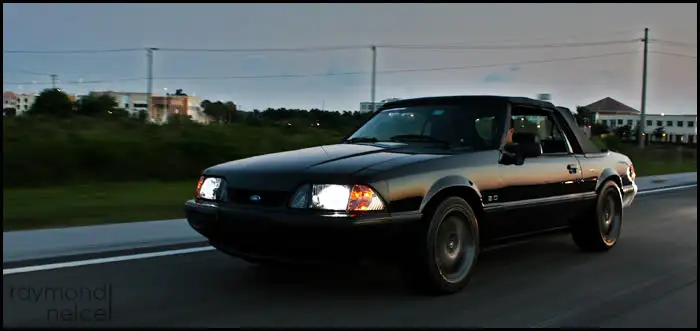

I couldn't find the New Member Section. Hey everyone my name is Alex,I live in Miramar,Fl and I have a 1990 Ford Mustang LX 5.0 with a few mods,Explorer Upper and 93 Cobra Lower,Ford Racing lifters,B303 cam,65mm TB and spacer,70mm SN 95 Mass Air,BBK CAI,Steeda Underdrive Pulleys,Ford racing Timing Chain,Steeda F/R Swaybars,Steeda Strut Tower Brace,Ford Racing C Springs,Polyurethane Isolators,Motive 3.73's.
^This was stock

sick lookin vert! Welcome to Stangnet!

sick vert!! always cool to see another member from the sunshine state.....or the watch it rain every day at 3pm state.

thats a hell of a good looking vert...

Nice 'vert I hope your able to figure out the problems.

I hope you get the problems solved soon. That is a very sexy looking vert though.

nice ride man, the wheels look good on it! hope you get the issue solved soon.

Welcome to stangnet! Very nice looking stang u have.
