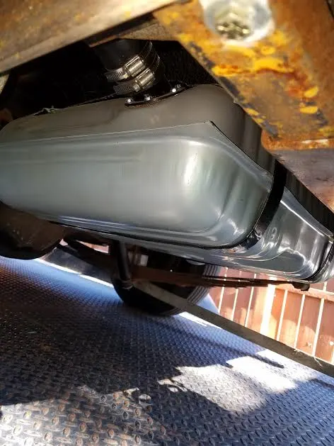

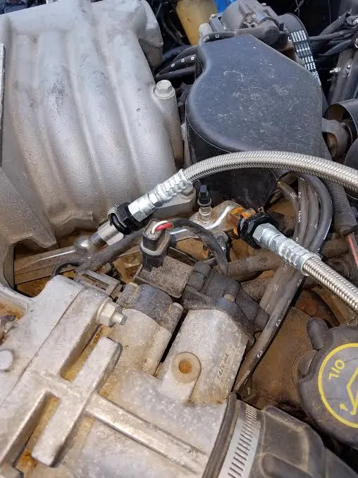

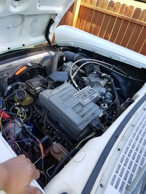

the tank pic is the new tanks inc tank with internal fuel pump and braided teflon lines all the way to the fuel rails feed line with a filter and return line both #6 custom tank to fit with fill line mated up to the stock location fuel door

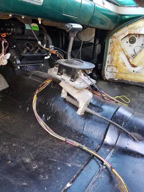

shifter pic is shifter from the mustang mounted to the trans tunnel i will build a counsol around it

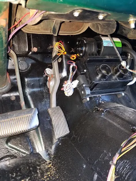

pedal pic is pedal from the mustang mounted and using the stock cable

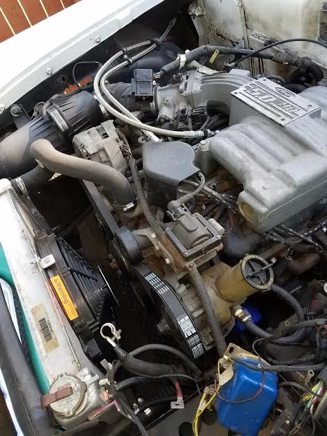

i used the correct belt for AC deleat and a new stock tensioner

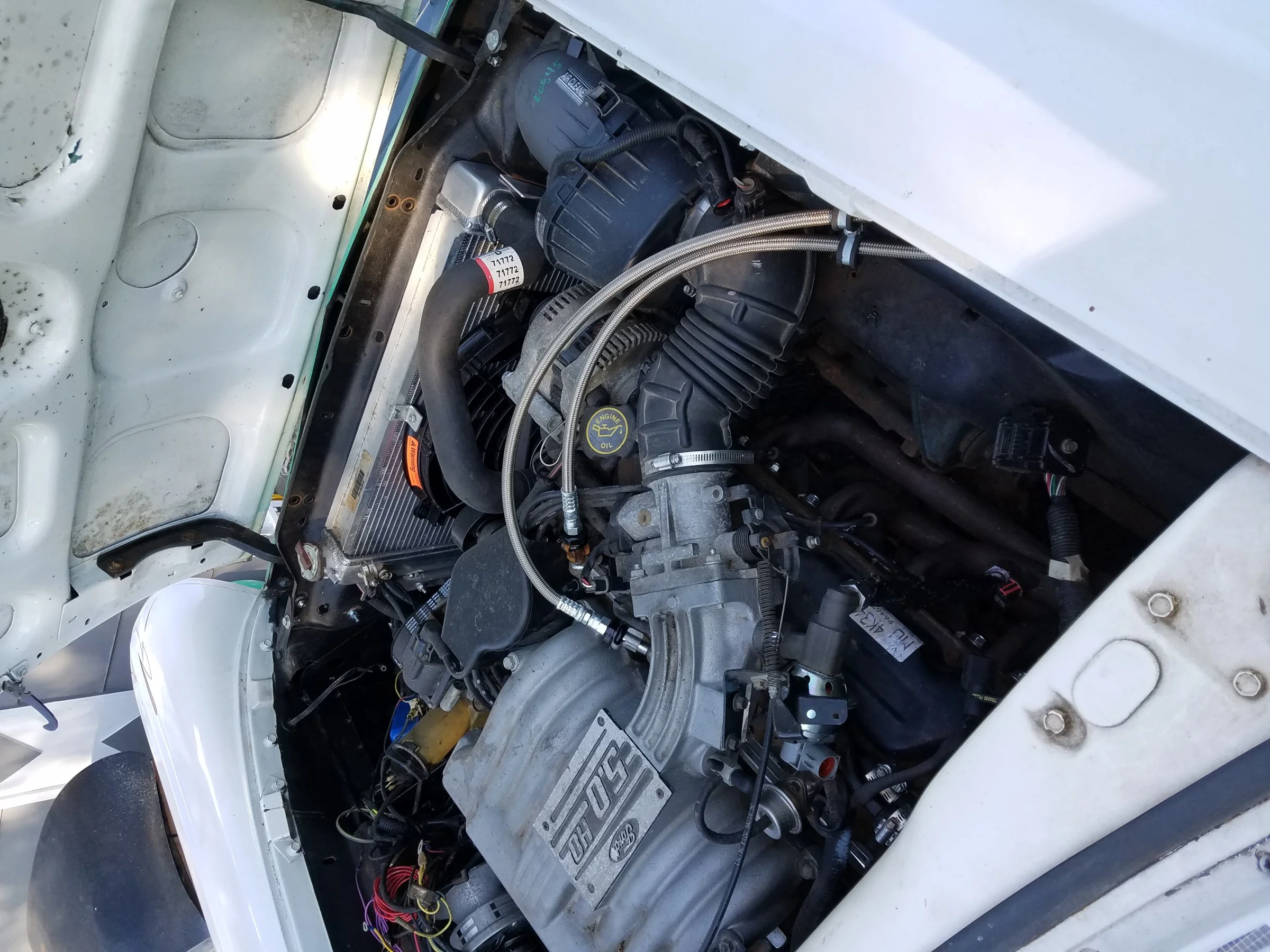

huge be cool radiator fitted into the core support took all night of cutting to make it look good but it look great
huge cooling fan with relay set up on a switch so i can control the coodown or warmup
to fit the 95 motor into the 57 frame i needed a 67 mustang pan and oil pickup with front sump to give me the clearance for the steering linkage
stock headers fit perfectly with only 1 small dent to clear the steering box the passenger side was a perfect fit
to fit the AODE trans i moved the stock crossmember back 3 inches and welded a plate at the height needed for correct pinion angle
to mount the stock airbox I cut out a section of inner fenderwell and ran the snorkle into the fender
i had a custom driveshaft made
i had to raise the floor in the back to fit the tank but its under the pare tire well and you can till fit a spare i also installed a trap door in the floor to service the fuel pump
spent all winter on the project working around my 60 hr a week job now all i need is to get the harness hooked up
the engine harness in on the engine and i have all the wireing and modules from the doner car 95 GT I jut dont know where to go from here i was hoping someone would be able to tell me what to hook up to get it running
