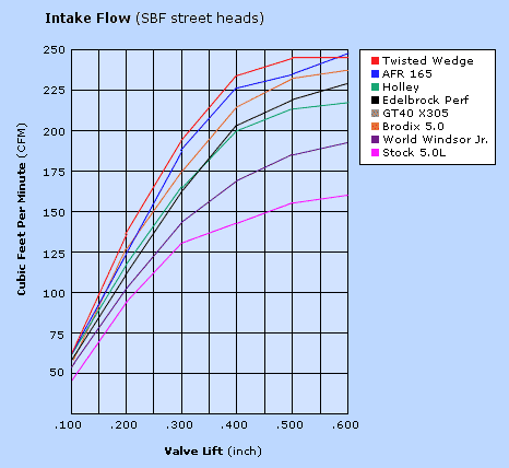

Intake Flow Chart from FordMuscle.com

You can pick up a set of TW heads for under $1000 & AFR's run $1300, usually. My money will go to trickflow.
Scott
Heck, if all you want is a lot of flow, then you can get heads that flow a *lot* more than any of the ones on that chart. Why not pick up a set of blue thunder heads and put them on your 302? :rolleyes:
