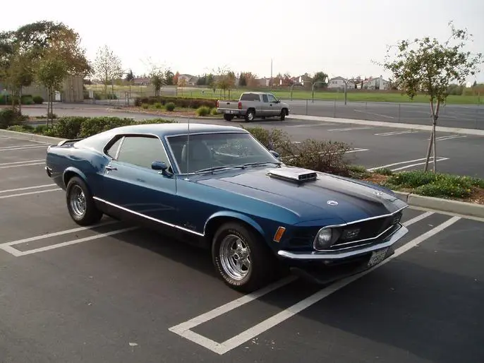

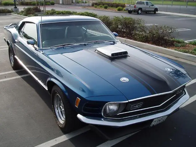

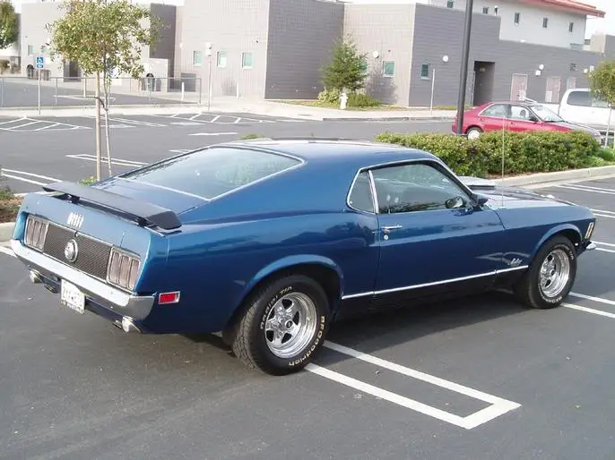

New here, gotta '70 Mach 1 to show off and get advice
danorth
Apr 29, 2007
All done up except the engine. I know, backwards. 351C 4v heads, 4 spd hurst, 3.91.
I would like some input as what to do with my second engine I have just sitting around waiting for a project. It is another 351C 4v. Any suggestions where to start reading? 400-500hp is the goal.
Thanks, Dan.
