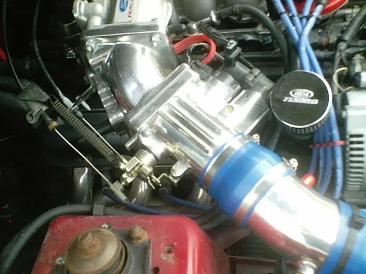

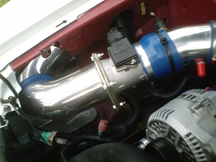

both heads say GTP on the corner next to the bolt... whats the difference in the GT and GTP heads ? and they have the long threaded plugs in them and I looked at the old ones I took out and they don't appear to of had any threads sticking into the combustion chamber. wich heads are better? and I will check the computer in a few minutes for a chip. and the tops of the injectors are orange. not sure of the brand of MAF or throttle body but here are pics of them.

The Throttle body appears to be from Pro Products and it looks as though you have stock 19lb injectors and stock MAF. I would personally steer clear of the MSD distributor as some people have problems with them although some don't. You will probably not get any power increase from it as well. The MSD 6AL and coil should be fine though.
