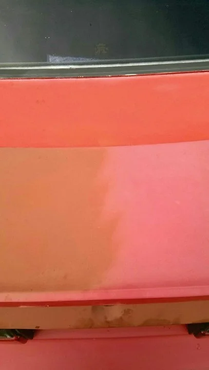

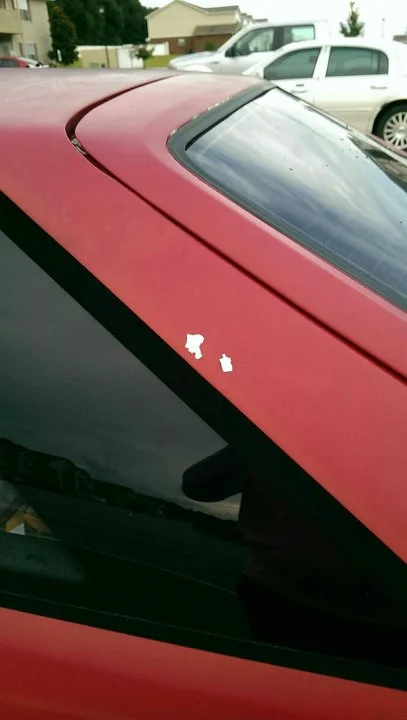

You would be surprised how far back from the dead you can buff red paint if you know what you are doing. Other than the hood, the rest of the car may be the same color red underneath all the oxidation.
Unfortunately I'm not sure. The PO started trying to repaint it a different shade of red. And somewhere along the way when it was repainted the never sanded down the original paint so the original white paint is starting to show in places.. I could definitely try to wash and buff her up. May help some.
A quick way to know if it's a half ass paint job is take a blow gun from an air compressor and blow it on the paint. The paint will just lift off and blow away. Most people don't know how to prep. A $200 quart of paint won't make up for cheap prep work any day of the week.

Differences in color.

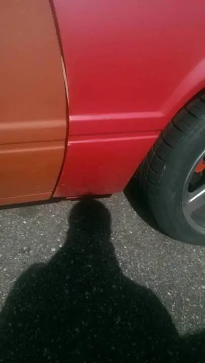

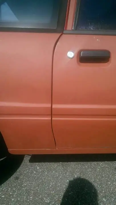

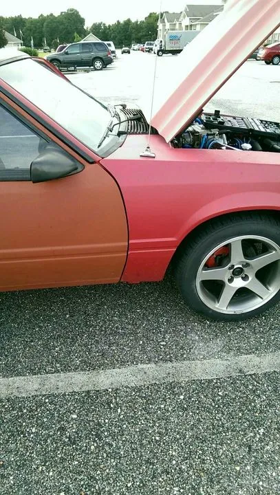

Yeah paint would definetly be high on the priority list for me. As long as it runs descent first that is. Somebody had to replace that frontend. The alignment is atrocious.
Best way to fix that? I was hoping that when I replace the door hinges and bushing..
Could be the fenders that are off and not necessarily the doors, so you might have to play with the alignment a little bit. Do the body lines match from the doors to the quarters? If they do then the front end is your problem.
your door looks fine. Remember that these cars were made in the 80's when American cars had horrible tolerances so fender gaps were never lined up like a Honda would be. Ever heard of Tolerance Stacking? I have to deal with it all the time at my work because people get lazy sometimes. Your problem from what I can see is the top of your fender doesn't match up in height with your cowl. The lines are not aligned. The bolts you need to loosen are 8mm and located where your door jamb is, open you passenger door and look toward the jamb near the top of the fender. You'll need a long extension. Open your hood and loosen all of the 8mm bolts there too, should be 3 of them. There is also one more located at the bottom of your fender near the bottom of the door, loosen this one too. You do not need to remove them. Try to manipulate the fender to line up with the cowl while maintaining the gap with the door. When it looks good tighten one bolt down good and check all gaps. Open and close your door carefully to ensure door doesn't his the fender. If your happy tighten everything down if not loosen it back up and try again.
take some painters tape and lay some on the edges of your fender and doors. You don't want to chip off the edges when you are aligning them and checking the door opening. Also, your door gap to the rear fender is wider at the top than the bottom. You can see where the lines don't match up on the upper and belt molding. Check the door bushings/pins as they probably need to tbe replaced. You can also try and adjust i a little with the striker.
On second thought, you may want to check if some (not so smart) person shimmed your fender. The shims would be located at one, if not all, 3 of the 8mm bolts under the hood. They would be sandwiched between your fender and the frame. Mine had a shim near the last bolt closest to the cowl/hood hinge. The front of the fender is off as well from the picture you posted. Loosening those bolts are a P.I.T.A. They normally turn on me. Spray PB Blaster on them and let them soak. Hit them with an air ratchet and they will have the best chance of loosening the nut instead of the embedded bolt.
