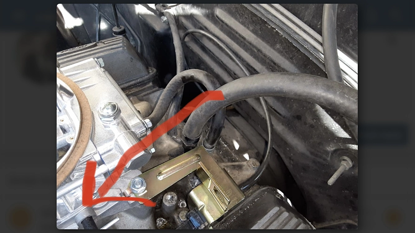

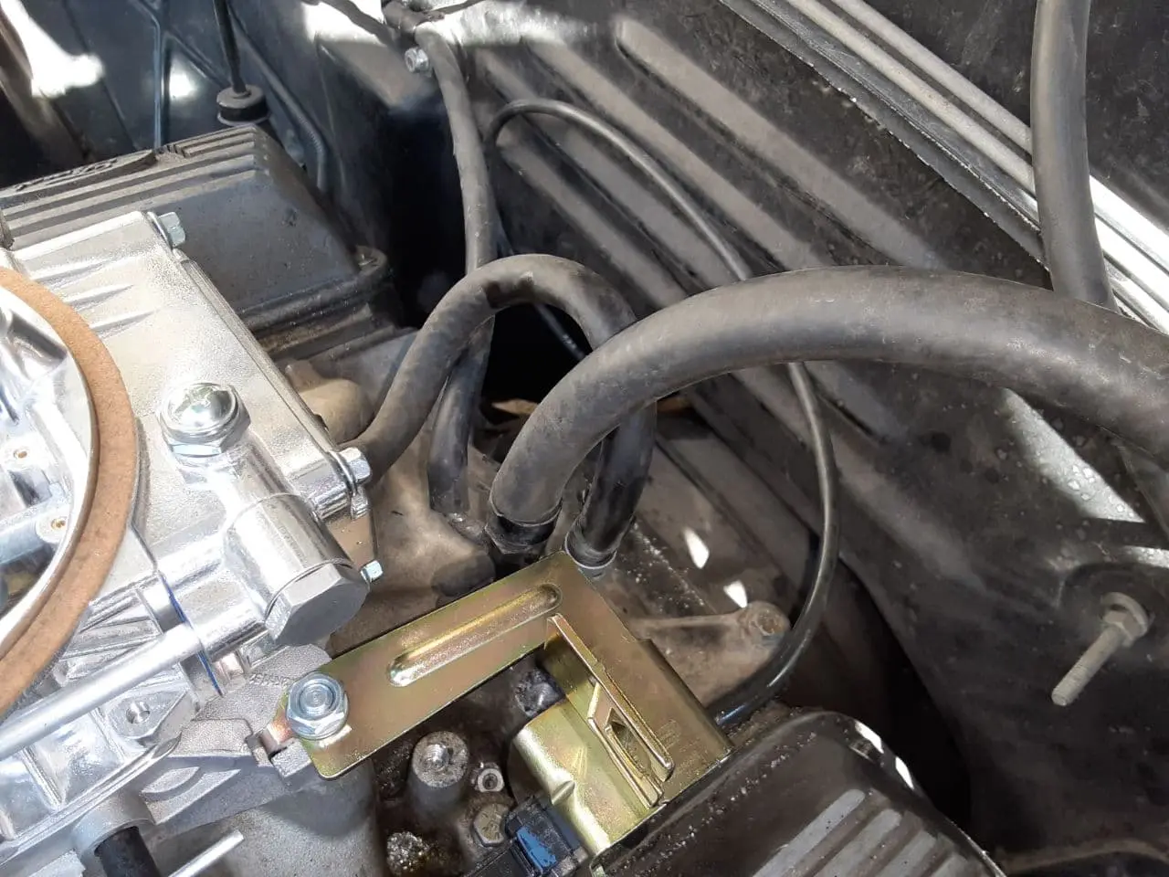

You either have a defective carb, ( twisted shaft) or a vacuum leak as a result of a warped base plate, a bad base plate gasket, or a missing vacuum plug. Are you hooking the big vacuum plug that goes to either Power brake booster, or PCV at the rear base of the carb? If you are, unhook that hose, and plug that off to eliminate that potential leak point.
I'll check that plug at the bag of the carb and make sure it's capped. My intake manifold has a threaded multi prong spigot that my brake vacuum hose is running off. In this picture I htink you're talking about the black plug on the lower right? I have the other two on the left (front of carb) still plugged off. And then my distributer vacuum line is going to the spigot just to the upper right of the choke in this pic.

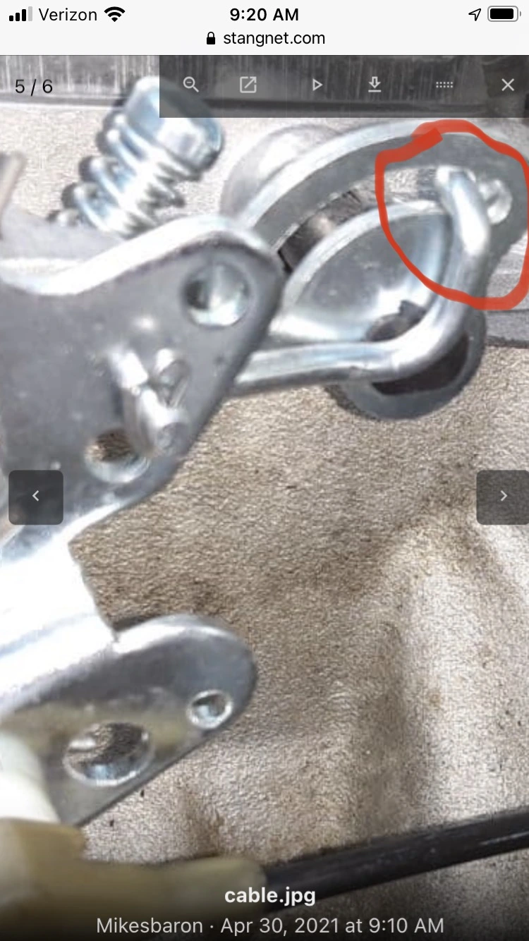

Please take a close picture of the linkages on the side of the carb where the arrow is pointing to off the edge of the photo and I can show you. My Holley powered car is still winterized off site.
I verified that the secondaries (the two small valves on the other side of the carb-not under the choke valve) are closed. I also verified that the red choke cam is in the proper position, depending on whether the choke plate is open or closed. Choke plate closed its up and choke plate open its down.

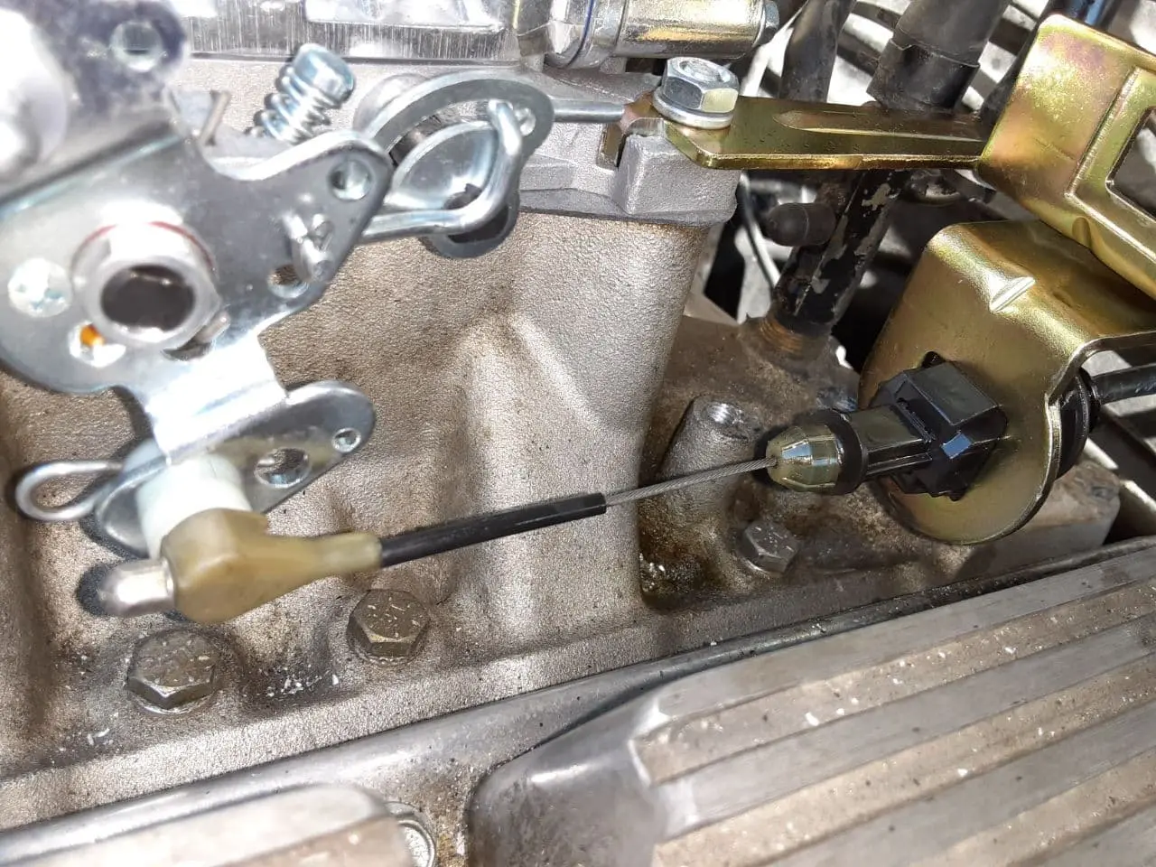

Will this pic suffice for you to point out where something might be bent?

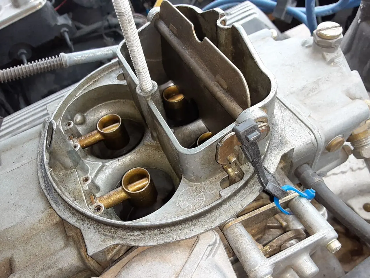

Also, here is a pic of the carb I took off the carb. Notice how the choke plate was zip tied open. The car seemed to run and idle fine, just had to tap it a few times in the morning to get it to work without choke plate. Could that indicate anything I might be overlooking tied to the current high rpm problem?

The link end I circled is for closing the secondaries. It’s the one some fools bend to open the secondaries (instead of close them). Then the secondaries open and can stay open. (Whee!) I will stop by my carburetor powered car to see if that much gap looks right and if the link is in the right hole on the same model. You say you are sure they are closed all the way, but air is getting in somewhere. So let’s rule it out.
If closing the choke flap all the way slows down the stupid high idle, it still sounds like the primary butterflies are open too far. When you check the base gasket, inspect the bottom of the carb to make sure they are closing as far as you think and the gasket has not been interfering.

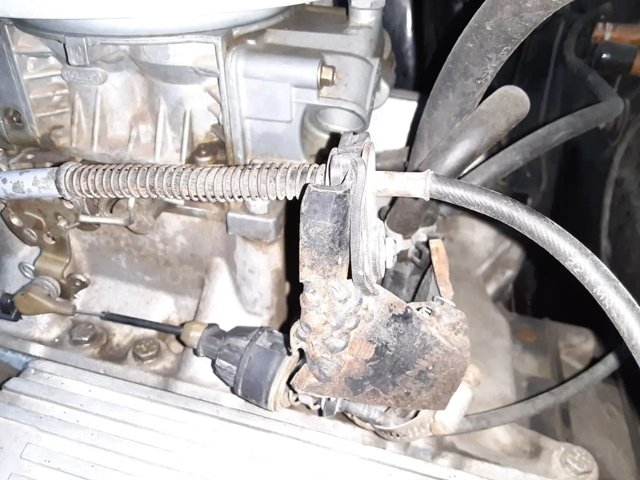

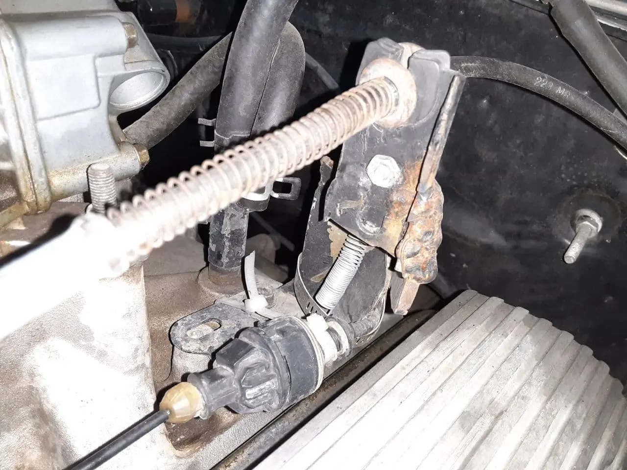

I pulled the old carb off because it was too big, 750cfm, and it had a bad bog in the low and mid. Plus look at how the TV and throttle cable bracket were held in place. It would slip in gear at high rpm if I gassed it (mal adjusted...obviously) TV cable. I had no history or trust in the carb, no telling when it was last cleaned, or rebuilt. And it was suggested that the proper cfm carb would help me run without the bogs, that vacuum operated secondaries would be best for a street car.
