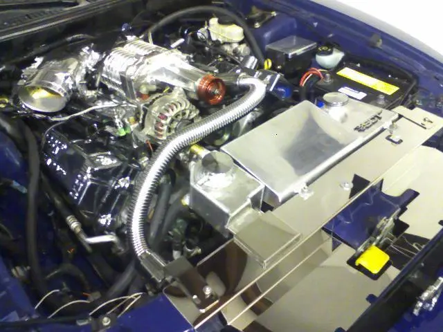

Im almost there....
I dunno, there is a lack of info in that post.
Like where it was dyno'ed, if the numbers are corrected, ported sc or not or
Other mods to the car.
I have trouble believing a 2v car, with less boost, makes more hp than an 4v 03 cobra.
Figure a ported eaton on an 03 cobra with 16lbs of boost makes 520hp. Non ported makes a maximum of 490rwhp.
And most twin screws could surpass 600rwhp, the problem is that it requires a built shortblock, so most guys keep them in the mid to high 500's on an 03 cobra, and low 400's on stock 2v.
