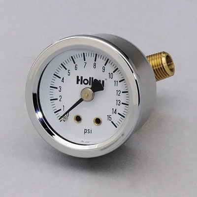

new tank and lines.I just took it down the road and no stumbles or hesitation, so maybe it is ok. My eyes maybe just be deceiving me. i need to get a fuel pressure guage. is there one that goes inside the car (mechanical, electric, isolator) Does autometer make a phantom for inside the car?
jb1dsl said:
i need a pressure guage
There's a few of them here:
http://store.summitracing.com/default.asp?target=egnsearch.asp&N=400178+302458&autoview=sku
Just don't get a 30 psi gauge for a mech pump and a carb, even the 15s are too high.
