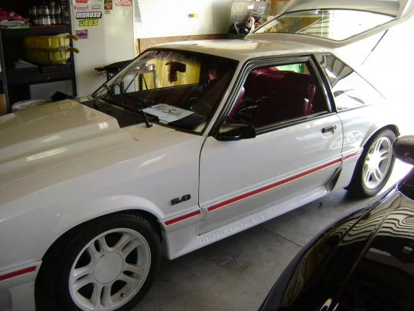

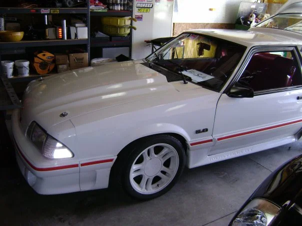

put these rims on it.... there 98 gt split 5's
i had b-lowering springs with no isolators, sn-95 front spindles, fox length moser 5 lug axles.
if i were to do it again i would go with these rims with 95 or 98 rear axles to push rims out more towards fender lip. im a huge fan of oem rims on a fox

Thanks for all of the tips. Those white wheels look great on the car. I was wondering what white on white would look like.
