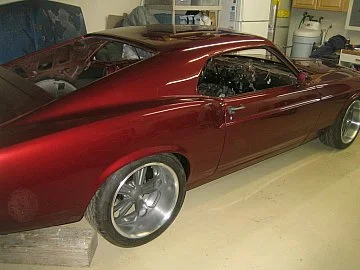

thanks for the compliments. i'm using budnik cannon wheels 19x10 and 18x9 (295 35 19 and 255 40 18) backspacing is 4.25 in rear (rearend has been narrowed 4") and 4.625 in front. inner wheelwells were reworked in the rear as well as rolled fender lips front and rear.

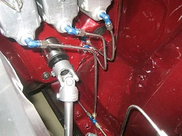

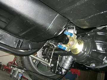

Thanks guys, been busy running e brake,fuel system, hydraulic clutch, and brake hydraulics. Most hydraulics are being run inside vehicle and exiting where needed (lots of bulkhead fittings!) Revamped the Wilwood hydraulic clutch with heim joint and clevis at the clutch fork (MUCH smoother operation) anyway, as we all know the little details take the longest. and as soon as I can get this thing back on the ground and get some overall shots i'll post them. here's a sneek peek of the rear before carbon fiber tailight panel. (Tim, get back to work on that cougar!)

IMO I think these wheels look in proper proportion to the overall look I'm after. Rocker panels have also been extended downwards 1.25" towards the rear creating the illusion of a bigger wheelwell.
