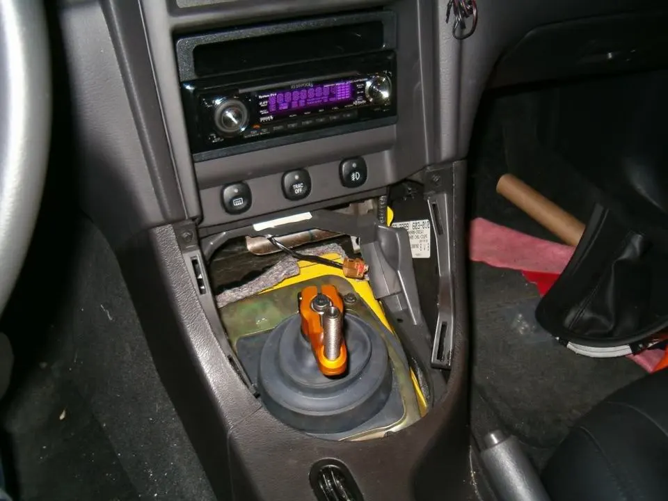

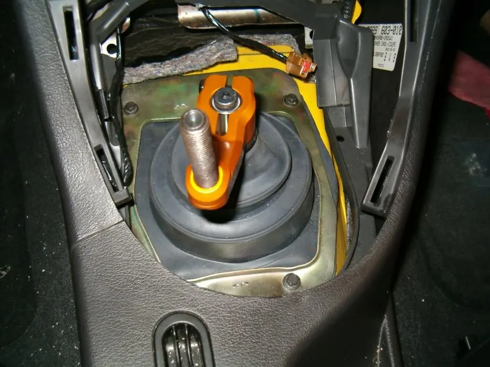

Here are some pics of the install. Test drove - love it! A little stiff, but its great. I've seen lots of references to more noise, I hear a little bit of an "airy" or "hissing" type of noise, and also the shifts seem a bit notchier, almost like its clicks in place....normal? Also, left the second inner boot off, maybe that would help with noise.

hey i need some stop bolts! anyone willing to get rid of theirs. since so many of you arent using them i'd like to have them. i just bent the 1-2 shift fork tore out the 1-2 syncros and the blocking rings and sliders. i'd love to have a set of those bolts if you dont want em
